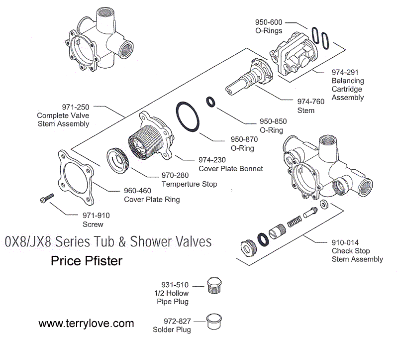

I've attached a pic of the writing on the bottom of the valve
Price Phister
The temp setting was the middle one.
I'm going to home despot now (hardware store) to get a replacement cartridge as this one is old
I'll install the new one to the higher temp setting.
If I could get anywhere close to 120 I'd be plenty happy with that.
I'll report back after the "operation seeking warmer water"

Phister has a temperature stop that can be rotated behind the handle.
Terry, my shower faucet is missing the temperature stop disc. When I turn the handle clockwise, I am not getting enough cold water and the pressure drops. Is there another way to adjust water temp mixture?
Terry, my shower faucet is missing the temperature stop disc. My water doesn’t get cold. When I turn the handle clockwise to cold the pressure drops and it stays warm. Is there another way to adjust water temp mixture?

Without the disk, on some designs, it is possible to rotate the valve handle beyond design limits, and that can go right through the hot range, back into the cold...so, without the cam in there, you might not be able to just rotate the thing max, and then expect it to get to hot...try it from off gradually increasing it, and you MIGHT get a temp you like. Also note, some cartridges can be installed in two positions, to allow for the hot/cold to be reversed (this can make the plumbing easier if there are back-to-back showers...so they don't need to cross the lines). You might have the cartidge in in 180-degrees out.
