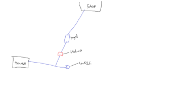

1" line to the curb stop valve - 1" line to a 1"-1"MIP-1-1/2" - 1-1/2" poly line out to shop?
No valves should be located between the pump and pressure tank/pressure switch (PT/PS). Closing a valve before the PT/PS will prevent the PS from receiving flow from the pump, so the PS will not sense any pressure rise, and is likely to cause the pump to continue running and overheat, likely to burn-out the pump.
While a yard hydrant maybe installed between the well and pressure switch, if utilizing a CSV, the CSV will need to be located before the yard hydrant, likely within the well or within a sufficiently deep pit to prevent freezing, located just after the well's pit less adaptor.

I have attached image of what my setup would be like, the pressure tank and pressure switch are in the house, I am just simply tapping to it not placing any valve in line of the well and house.
