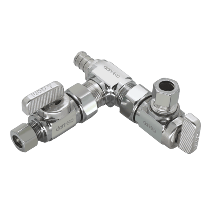

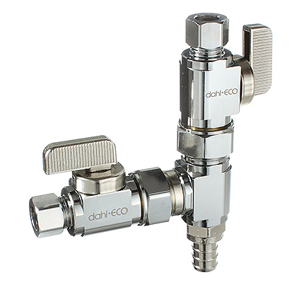

I found that Dahl does sell a package that includes a pex crimp to dual mips adapter that would save one piece vs pex to single mips to a T but they didn't reply about anywhere that sells it locally and supplyhouse is backordered. They don't list that adapter separately.

I found another one .. Crimp on valve with 2 outlets. Guess its not really replacable without cutting pipe tho.
Or perhaps a single straight stop with a stack on tee splitting the 3/8 outlet
Or another version of the Dahl setup..
