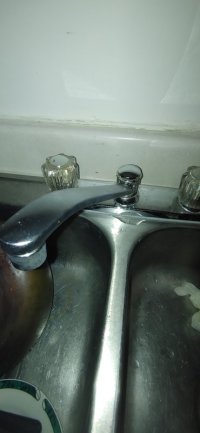

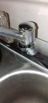

Changed out basket strainer and tail piece to notice water leaking also from beneath kitchen sink faucet. Not sure the brand of faucet, was wondering if anyone may know the brand and possible issue. Want to make sure i buy the right repair parts

For a faucet like this, I think a close up of the top of the handle might give the best clue as to the brand and or removing a handle to reveal the stem of the cartridge to see that part.
Does it only leak when you're using it.. IE from the spout only?
41,408
4,996
"beneath kitchen sink faucet" is vague. Is the leak at the attachment to the stop valve, or somewhere up high?

you could just get the 2 o rings probebly not brand specific. so who cares the brand?
