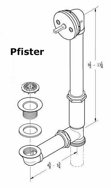

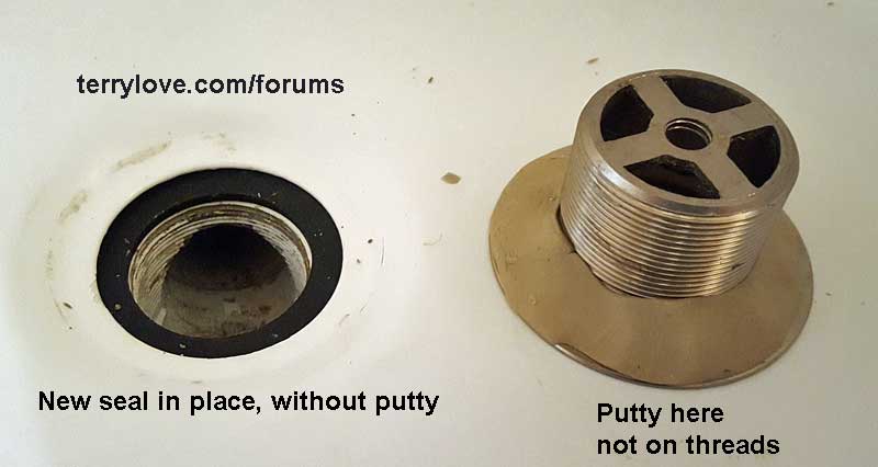

The plumbers putty under the flange has dried out and allowing water to slip by. Under the tub at the shoe, the rubber gasket may also be dried out and leaking. It takes both to fail. The fix is doable from the tub side. You remove the flange, pull out the gasket and replace it with a new one. Plumbers putty around the flange, reinsert the flange. There are plenty of you tube videos on how to do it.
https://i3.wp.com/edmondbathtubrefinishing.com/wp-content/uploads/2014/04/Bathtub-Drain-Diagram.jpg

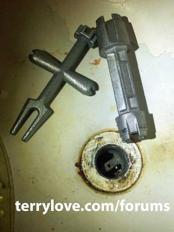

What seals the tub drain is the rubber seal between the tub and drain below. The putty doesn't really do much.
Two different tools I use to remove and install drains.
https://terrylove.com/forums/index....eaking-how-do-i-fix-it-leaks-from-shoe.71774/
