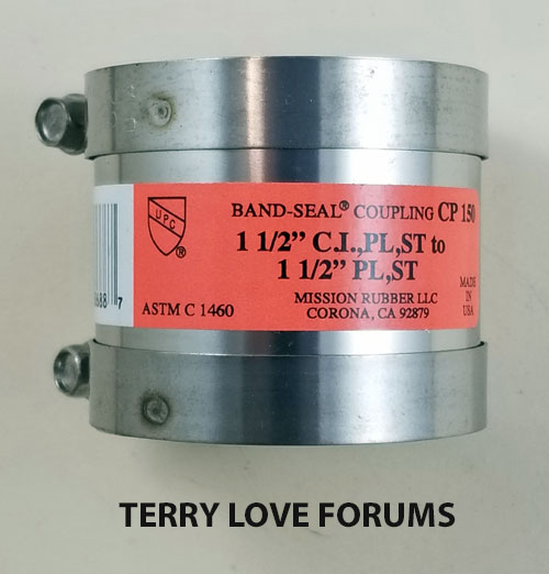

A lot better.
ABS and PVC don't glue up together. A coupling with metal wrap works for that.
What about the oatey PVC to ABS transition glue? That’s what I planned to use. Any experience with it?
