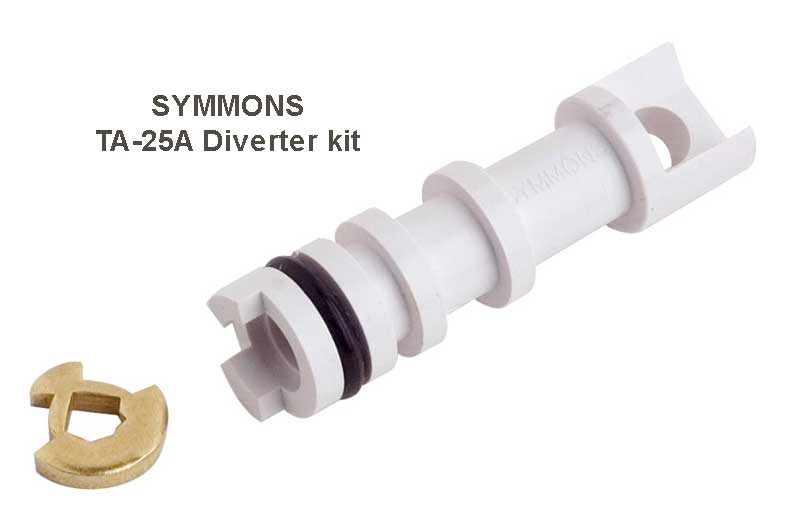

It's a symmons temptrol tub/shower valve
this is a link to the replacement diverter part # TA-25A

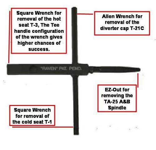

The Symmons Temptrol usually rebuilds quite nicely as long as the water isn't to hard however the parts do add up.
I usually install new T-4 hot and cold seats, a new TA-10 Spindle, and the TA-25 A or, B volume/diverter spindle with good results.
By the time you add up all the individual parts your better off just hitting big box and buying the whole valve for about $90 and swapping out the parts. It also gives you the option of having the valve on hand to replace it if the T-3 seat strips out.
The valve should be open before attempting to remove the T-11 cap or reinstalling it.
Raven Products makes a great tool for the Temptrol which I prefer over the T-35 seat tools. You will need one or, the other...
I've done better write ups here in the past use the forum search to find them.
here's a pic of the Raven Products Tool
