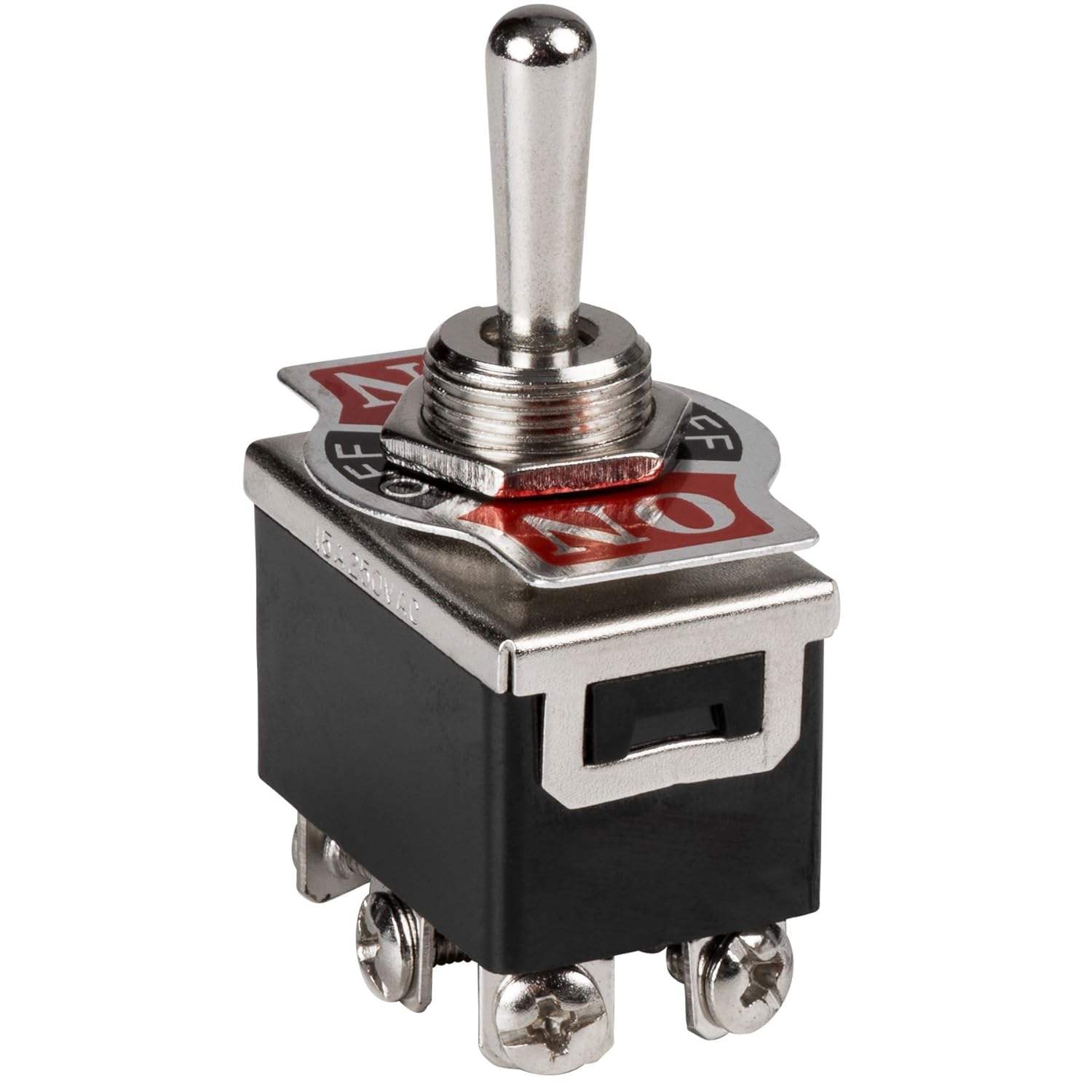

You could use one of these, It would give you 2 speeds and off.

Very good, I found this photo and I believe it's what ur talking about in a three gang box? One single and two double light switches? I like that small toggle Don, I guess a low and medium would work fine. No worries on the dogs tail, it's been gone.. Lol.. I do have an 8 ur old running around so I'm gonna put some expanded metal over it.. The wires coming out of the fan is 16 or 18 awg but the insulation is larger than normal wire I've dealt with. I have some 12awg wire in armoured cable I could use for a plug, I've been using a 15ft drop cord and the wire isn't hot but the fan motor gets pretty warm. Should I be using a heavier wire than the 14 gauge drop cord?

You are making things to complicated. Looks like you are building a Start Sequence launcher for a Rocket Motor. No Rocket Science needed here.
Just use a 4 position switch if you need all 3 speeds, Why would you use 3 different switches ? I would not do that, No need.

That is a complicated way to have access to a four way switch Don, that's why I asked. Common sense told me I'd need a switch like that but nothing is available around here. I did make it simpler, I bought a pack of male/female blade plugs, the ones you crimp onto the wire. I'll just plug my supply hot to whichever speed I want, no switches just three female plugs one male. A rocket motor huh? Hmm.. Never know...

You can get 1 switch that will do it. Digikey may be a better choice. Or Military surplus.
