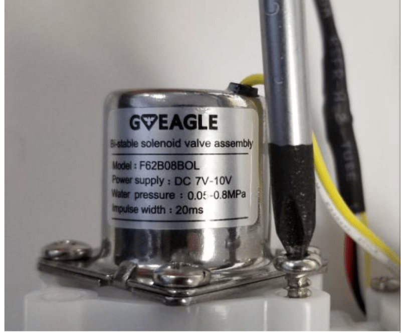

I have a smart toilet (Ove Stan) that is built using this valve
Here is the valve manufacturer page but I can't say exactly which one of those is my valve.
http://www.chinazhanying.com/en/products.php?cid=3...
It is acting strange as described below

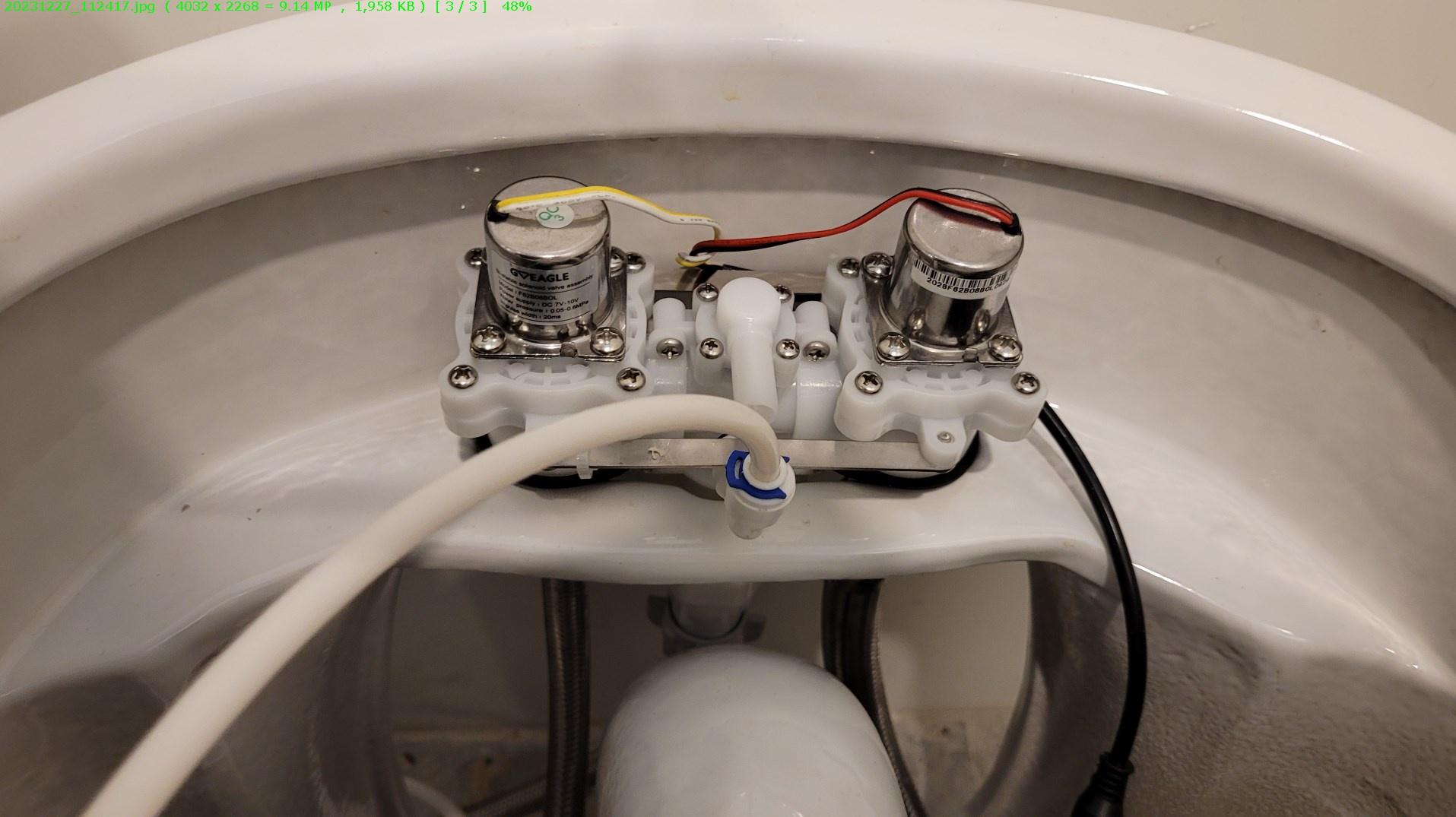

Here is how the toilet works: when I flush the toilet there is two valves that open in sequence:
he left one in the above picture is what they call the whirlpool valve which is cleaning the toilet bowl before flushing it.
it basically sends water to make sure that all goes to the bottom of the toilet.
After that this valve closes and a second one situated at the bottom of the toilet opens and it flushes/pushes everything into the drain.
The problem: the wirlpool valve is not working any more not as it used to. In normal conditions it won't open at all anymore.
However by accident I discovered that if I open the sink tap half way that decreases the water pressure in the pipe that supplies both the toilet and the sink and then if I flush the toilet while the water is running everything works relatively normal. Obviously there is a lower pressure at the bottom valve in the toilet but it is still enough to push everything into the drain
I am not sure if the valve is broken or it is that the water pressure is too high and I should try to lower it at the toilet supply end.

Based on the valve manufacturer pictures it should be easier to replace just the valve from above.
If based on what you see in the picture (Model F62B08BOL) you know of an equivalent please let me know

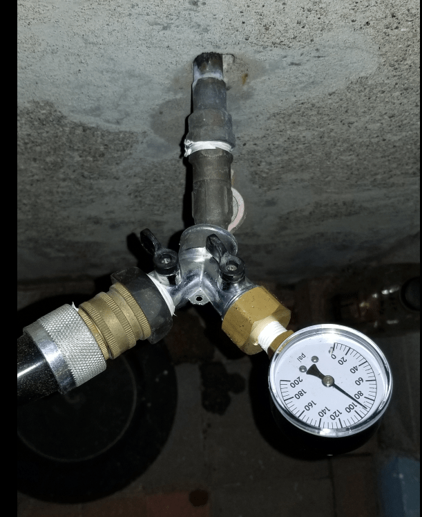

The water pressure measured at an outside water tap is shown below. That is located just before the pipe enters that bathroom.
It shows around 90PSI, the valve is rated for 0.8Mpa (116PSI)

When you do not have enough pressure to keep two taps open, what does your pressure gauge on the hose spigot indicate?
When you do not have enough pressure to keep two taps open, is that the case if one is the kitchen sink? If yes, I would be looking for a clogged filter. Some PRVs have strainers (a form of filter).

Plastic solenoid valves are really not made for that pressure full time. 60 lbs max is what most houses ever need higher pressure just wears out in the system faster.

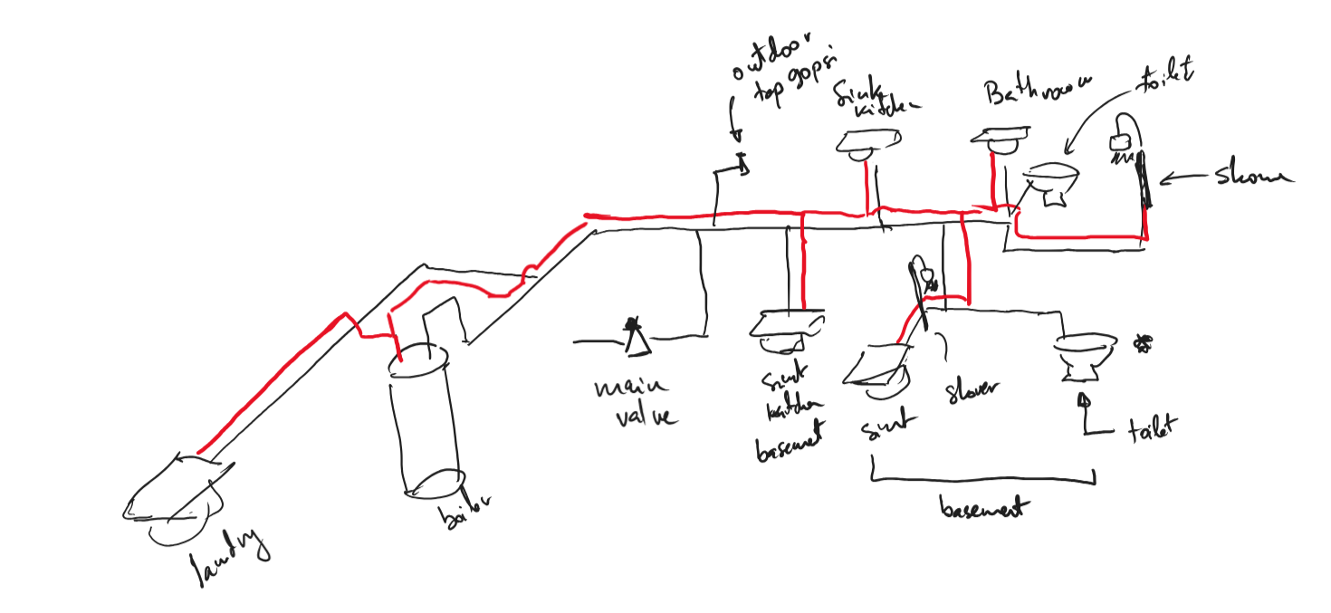

here is my plumbing
where could the bottleneck be ?

Non-responsiveness is one kind of bottleneck. Troubleshooting could be easier.
Pipe under the front yard could be crushed.

@Reach4 ...no tap in the waterhouse is siffering from low pressire when it is open by itself. A crushed pipe would be a constant bottleneck no matter how many taps are open.I need a way to measure the pressure at one of the sink ends.... if it still 90psi thr thr pipes should be unobstructed

Besides the hose bib, you can put a GHT pressure gauge at a laundry tap or the drain on the WH. This will let you check the pressures, and deduce where the main pressure drop is coming from.
Did you not say that the pressure gauge on the hose spigot dropped by half???? If you did not say that, then say what gauge pressure does when you turn on your two-faucet load.

BTW the valve seems to be 1/2" not 3/4" as depicted in the above manufacturer instructions.
So to recap:
-it is an 1/2" sharkbite valve connected via a 3/8" Compx 7/8" BC flexible cord to the toilet
There is an interesting detail you can see in the picture:
-the first valve is using a larger ID flexible cord (3/4") than the valve that is in trouble here (seems to be 1/2" ID)
