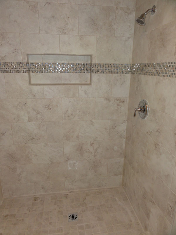

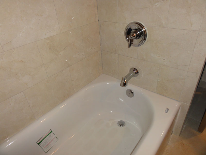

Here is the same valve as above. A Moen Posi-Temp. I just trimmed this out today.
I like the fact that there is a range that the valve can work at. I'm not a big fan of tearing things out when the surround that gets installed is either too thin or too thick. Moen is pretty hard to screw up. Even if it's set too far back, it's doable.
Kohler does have some tub shower trims that do have a more consistent finished look to them though. There are some options in valve selection.

Here is one I did a few weeks ago.

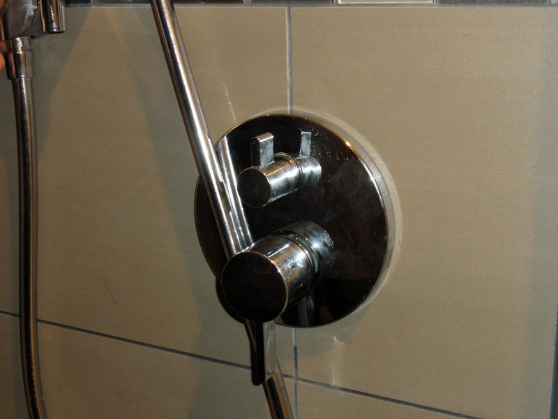

I trimed a HansGrohe a few weeks back, and the tile setter had furred out the wall almost to the point where the valve might not have worked. We would have had to go through the back wall and moved it forward. And that one was set right in the middle of the spec. At least when I left the job.

A Moen Posi-Temp installation.
Awe come on Mr. Love, show us one that you've done where the handle sticks out an extra 1" or more. You know, the ones where you get wrinkled when people say it looks crappy even if it's technically within specs. Oh waaait a minute, you're not telling me you just think the ones that are nice and tight like that look better are yah? Like they looks more "professional?" ;)
Or maybe you're trying to show me how good your tile setter is?:rolleyes:
