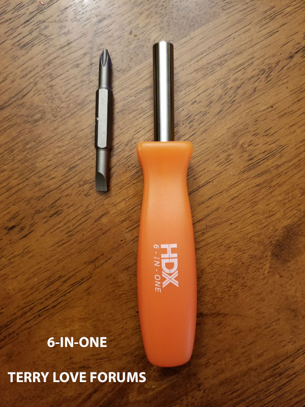

You can also use a screwdriver in the end of the arm for leverage.
I always do the screwdriver method, works great and I always have it in my pocket when trimming showers anyway

My channel locks handles grips were always cut from using them to tighten shower arms til I starting just using a nut driver.

Thanks for the replies everyone! Makes me feel better that some of you pros use a tad bit of additional leverage than just your hand on the bare end of the shower arm. The threads are kind of sharp too, and the palm of my hand has a few abrasions from that. Good tip on the screwdriver too - I made sure to use my older set of chanellocks in the end because I didn't want to tear up the grip on my nicer ones.
