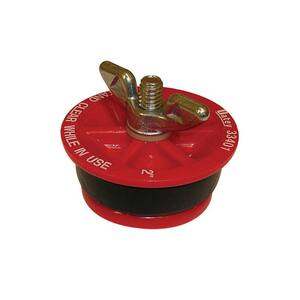

Above you see a simple 1.5" inflatable test plug. These work with an extension hose and bike pump. You can also use a plug that looks like this.
The yellow thing is an extension hose for the inflatable test plugs. Lying on it is a 2" inflatable test plug. At the top left a blue and orange twist and set plug.
All work. Getting the right plug is the key first step.

Different Types of Shower Test Plugs
Below a closer look at 2" inflatable and 1.5" test plugs. Both Inflatable and twist and set shown

A brand new 2" Inflatable shown above with a 3' extension hose. I don't recognize the valve end on the hose. What type of pump do you use to inflate that up Counter?
The valve end is a deflation tip/cap!!! I use my compressor @40psi. Then i use a gauge to verify..... I have 2 bike pumps neither will inflate this??? This is the only plug i can get down the quick drains ... Ill be flooding. Proline this week....

The test plug shown fits inside the 2" drain line. It test the connection of the drain to the 2' line and the connection of the waterproofing to the drain. It does not sit above this point and does not test for working weep holes.
