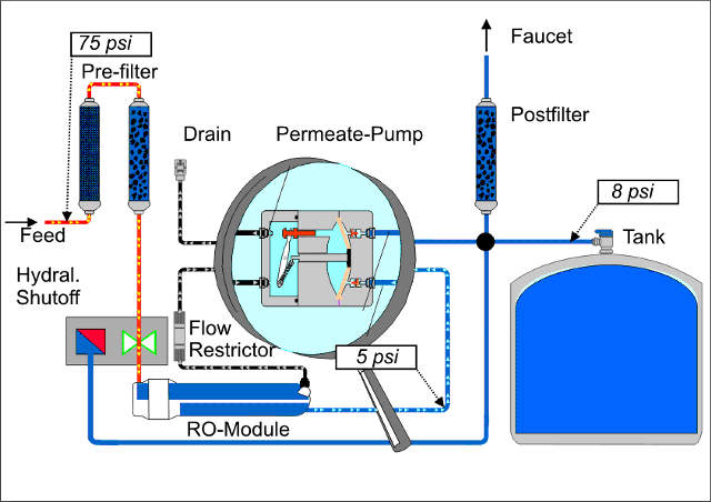

Drain flow from an RO is commonly called 'brine' as it contains the rejected contaminants that will not pass through the membrane. The composition of the brine will be dependant on contaminants contained in the water supplied to the membrane.
The drain flow rate is directly controlled by the drain flow restrictor which is sized dependant on the rated daily production rate of the installed membrane.
Methods to reduce the amount of daily drain flow include:
Replace the standard membrane with a Pentair GRO High Efficiency membrane. The GRO membrane requires less drain flow to flush away contaminants, thereby permitting the drain flow restrictor flow rate to be reduced, which will improve the RO water vs waste water ratio, often close to 1:1.
Utilize a permeate pump in connection with a standard membrane and drain flow restrictor. A permeate pump does not utilize electricity, but is 'powered' by the waste flow. Because a PP will pump RO water (permeate) into the storage tank as it exits the membrane, and will prevent back pressure from the storage tank from exerting pressure on the membrane, so the pressure differential across the membrane will be maximized, thereby increasing the quality of the RO water produced. With virtually no back pressure on the membrane, the production rate will be increased, permitting the same amount of water to be produced in less time, while also reducing daily drain flow as a result of the shorter production time needed per day.
A further potential benefit of using a PP, is higher RO pressure to the faucet & ice/water dispenser. A standard RO automatic shutoff valve (ASV) is calibrated to halt production once the storage tank pressure has risen to 60% of supply pressure. Because virtually all back pressure will be eliminated from the membrane, the 60% ASV maybe replaced with a 90% version, thereby causing production to continue until the storage pressure is 90% of the supply pressure, which will increase pressure and flow while also increasing the quantity of RO water in storage.
