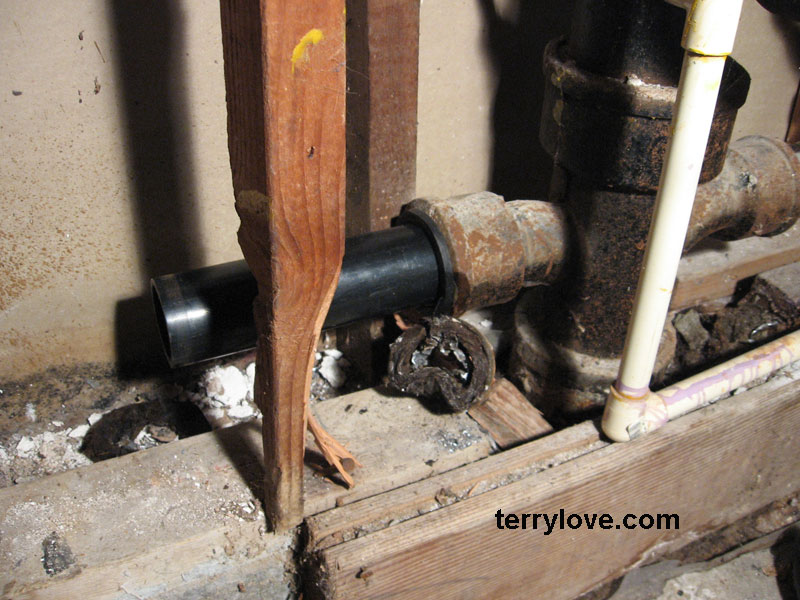

Im replacing an old tub on a slab in a 60s era home. The old drain assembly was brass. See picture of female brass fitting.
I assume somewhere buried beneath that fitting is a p trap. I poked around and didn't feel one though.
How should I proceed? Should I verify a p trap exists? Should I replace it?
How do I plumb this? I plan on a PVC assembly but unsure how to secure to brass. Brass pipe was just pressed into fitting. Should it be sweated?

Normally a trap should be with in 2 feet of the fixture and the trap with in 2 feet of the vent (MAX)
3,481
If you're installing a new PVC tub waste and overflow, dig down and replace the p-trap.
You can make the connection to the existing line there with a shielded coupling.
In Texas, a 1.5" trap arm can go 42" to the vent and a 2" trap arm can go as far as five feet.

Well having a terrible time getting the remainder of the trap out. All that's left is an inch or inside a female end. It turns freely, is loose yet it won't come out. I may have to hack saw it out. Any other ideas?

That is a lead and oakum joint. You can drill and pry the lead out of the joint, and replace with a rubber donut.
I bevel the end of the new pipe and lube it with liquid soap. Tap it in with a piece of wood and a hammer. Install a longer piece than you need and after it's tapped in, cut to the length you need.
