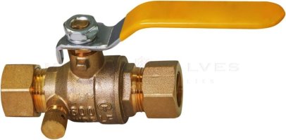

I was able to desolder the old valve, leaving the small 2" vertical pipe. I removed solder and sandclothed it down and then re-used that with a new ball valve from lowes. the job went pretty smoothly, but I either messed up with too much heat on the ball valve or I got a piece of crap valve (blue handle). Im attaching pictures to either warn someone or find the error in my methods. The instructions say to wrap the valve in cold water and solder it while closed. Im not sure how escaping gas, inside the ball after it heats, is supposed to get out, so I left it open. I did let the thing cool after soldering before opening/closing etc.
Anyway, I got the system in as seen in the 2nd pic. but then a pinhole leak, like 1 drop every few minutes formed with the ball housing brass joint, as seen in the pictures. I looked this up on lowes website to notice that several othes had the same problem, and one of them seemed to be a pro. so am I to conclude that the joint and ball/gasket material suck or i did something wrong? or is it that these ball valves are just too difficult to solder, unless a pro has the magic touch?
I'm tempted to try this again with a new same valve but dont trust them now. At this point, im thinking a compression ball valve (yellow handle) is the easiest way out of this mess. those are harder to find though, especially with the waste port.
the shark bite valve that pepe recommened looks appealing, but since both pipe ends are fixed, i need to buy another sharkbit slipend to install the valve easily. So that is more money, more failure points, and generally a hassle too. this guy in the link below shows the install with sharkbite and a slipend sharkbite fitting:

I dont get a laugh out of your problem . But I cant read through this whole novel. I think your work looks ok maybe you over heated but I think defective valve. replace the valve is about as deep as I can get on this you could actualy use a tee above the walve if finding a waste port valve is an issue . Frustrating I know and we have all had this type issues before I think its shit materials but I go cheap on stuff and get stuck using what I can find with less issues some of it luck for sure
