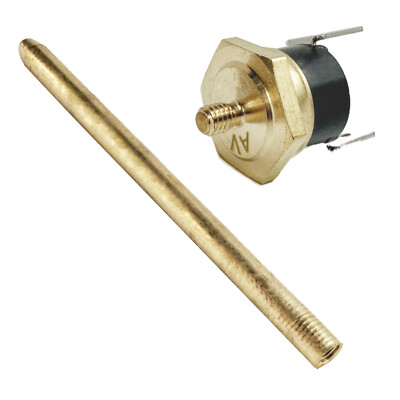

I removed the thermal switch from water heater. It has a 4" probe attached to it. Please see pic below. The part number on this ELMWOOD thermal switch is not very clear. It looks like "2450CMG7759-3 L450 N1121". I googl it but couldn't find. Anyone knows this is correct part #?
I found a similar thermal switch from eBay below. I can order it with different temp range from 125-140F to 195-210F. Which temp range is right for Honeywell water heater?

That sensor is in the burner compartment. The L450 in the number is more than likely L for limit 450 for 450°. Shoot that electronics company a email with the pics. They must be using it for a roll out switch a safety for if the burner would be burning with a down draft from the flue.

Thanks for your suggestion. I found the webpage below. Does it look right?
