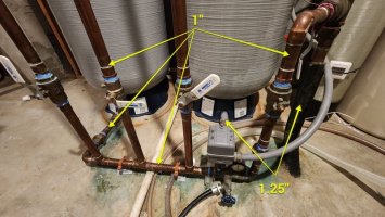

One more opinion, please?
- Service is 1.25", transitions to 1" after check valve
- One tank has 1" copper connecting to 1.25" inlet
- Other tank has 1.25" copper connecting to 1.25" inlet
Question: Should everything at the bottom this, from the service to both tanks be 1.25"? Or is the 1" reduction actually beneficial by throttling the pump? Or does any of this matter? Plumbing is HARD!

You do not really want to "throttle" the flow to the tank, but 1" won't do that and is still fine.

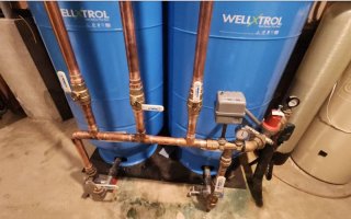

Alrighty then. This all makes sense when I watch the simulation, but I have trouble truly comprehending/believing in my mind.
Pump: Goulds 18GS15422C 1.5HP (2 wire)
Will be using both new tanks
Will be replacing check valve
Want to replace old tank tee...maybe 1.25" SS Boshart?
QUESTIONS:
1. What CSV would I need? PRV1A? Positive 1 GPM is best?
2. Lifespan/quality of the CSV?
3. What tank tee would work with this?
4. What union material? i.e., do I have to worry about dissimilar metals with SS CSV?
5. I have 40 year old copper supply line, about 50' - 60' run...all cool there? I've read your older posts, I know it should be fine.
6. I know you won't like this, but would piping in an additional bleeder loop be a crime to the CSV?
Thx! I really do appreciate the help from the forum.

With an 18 GPM pump you will loose 7 PSI for every 100' of 1" pipe. A short piece of 1" is not going to be noticed. And that 7 PSI per 100' is at 18 GPM. With a CSV it will probably never see more than 5-10 GPM flow, which makes friction loss a moot point.
Remove and do not replace the above ground check valve unless you just want water hammer and all the problems that goes with?
#1 You would need the CSV1A.
#2 Don't know. Oldest versions of CSV's are 30 years old and still working. Sand will shorten the life somewhat though.
#3 Lol! You really don't even need a tank tee or either of those big tanks if you screw a 10 gallon tank into the 3/4 port on the CSV1A. With two tanks you really only need 1 tank tee for the pressure switch and other connections. The other tank can just be teed into the line with pipe.
#4 With Teflon tape there is very little connectivity anyway. But galvanized is the only thing I would not screw into brass, SS, or copper.
#5 Old copper is probably better than anything you can buy today.
#6 and finish #1 You can bypass as much water around the CSV as you want. I can also make any size bypass inside the CSV when needed. But I have spent 50+ years figuring out that 1 GPM is the perfect number. Why would I want to change it

Thank you! I'm slow study. Will order a CSV set for 59 PSI.

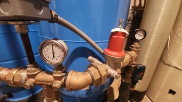

Received cycle stop valve. Very fast shipping and appears to have high production quality. Tried not to be a time bandit and come back to this thread, but I can't find a good answer anywhere on the web.
Question: What's the best way to transition from the stainless steel csv to copper?
Update. I think I found it on another TLF. Dielectric unions are poop. 6" brass nipple to transition.

Circling back to an old post. I want to thank Valveman and Reach4 for helping me think through this. It's a bit sloppy and unconventional, but I'm happy with it. My retired well plumber was not available to help with this. I do like the CSV. It's certainly cut down on cycles. Not sure about energy comparisons, but it seems to have smoothed things out.
Pipe dope hasn't been cleaned up yet. I use threaded valves because I still struggle with sweating valves. Above the photo the plumbing wicks down to 1" (I had 1.25" to get rid of). Cut-in, out set at 40-60. CSV set at 59 PSI. Pressure before CSV runs between 100-120 PSI. I went vertical with the well tee because I wanted a shut-off for each tank. Anyway, wanted to share.
