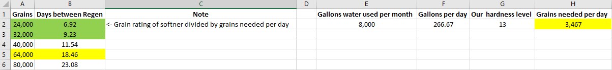

Pressure drop after 6 years, assumed fouled resin? Fleck 7000SXT resin needs for ~3,500 grains needed per day.
Mike Hawk
Broken Arrow, Oklahoma
Valve: Fleck 7000SXT
Water source: City water (river), Oklahoma RWD#5
Tank size: 12x48
GPG: 8-13
Gallons used per month: 8,000 (ouch). 2 adults and 2 kids. Wife and one kid take ~1-2 baths per week. Shower daily.
Our system:
When I ordered this system back in Q4 2015 I had a 64,000 system setup from the seller. 'Murcia? Bigger is better? 8% resin imported from out of USA, ie probably really junk stuff that all the online sellers sell. Water pressure was great for several years. A few years later we got a significant decrease in water pressure. I had never cleaned or dosed cleaner in the system. Just added cheap salt (ie no iron remover salt). My bad. Live and learn.
The system has been in bypass mode for ~2 years now. Started it back up the other day and it seemed to have great pressure for a bit but then after a day or so pressure was down again. I'm hoping/assuming it's just fouled resin and I just need to remove and replace the resin? I'll rebuild the valve if I have to but I've never done a rebuild. Hope it's not the valve since it had good pressure for a day or so. (shrug)
With the size of the current system (64,000) and our usage, it looks like it was regenerating every ~18 days. Probably not good for the life of the resin from what I'm reading and that 7 days is a better target? Looks like I could squeak by on a 24,000 grain system? 24,000 / 3,467 grains needed per day = 6.92 days between regen?
Tank didn't have a gravel bed. Guessing 1.0cf of 10% resin should be good enough after I reset the Fleck settings? Is a 12x48 resin tank big enough for us? How much 10% resin do I need? Which are reputable brands/sellers of resin? Where to get? Also, what sort of gravel do I need to get and how much?

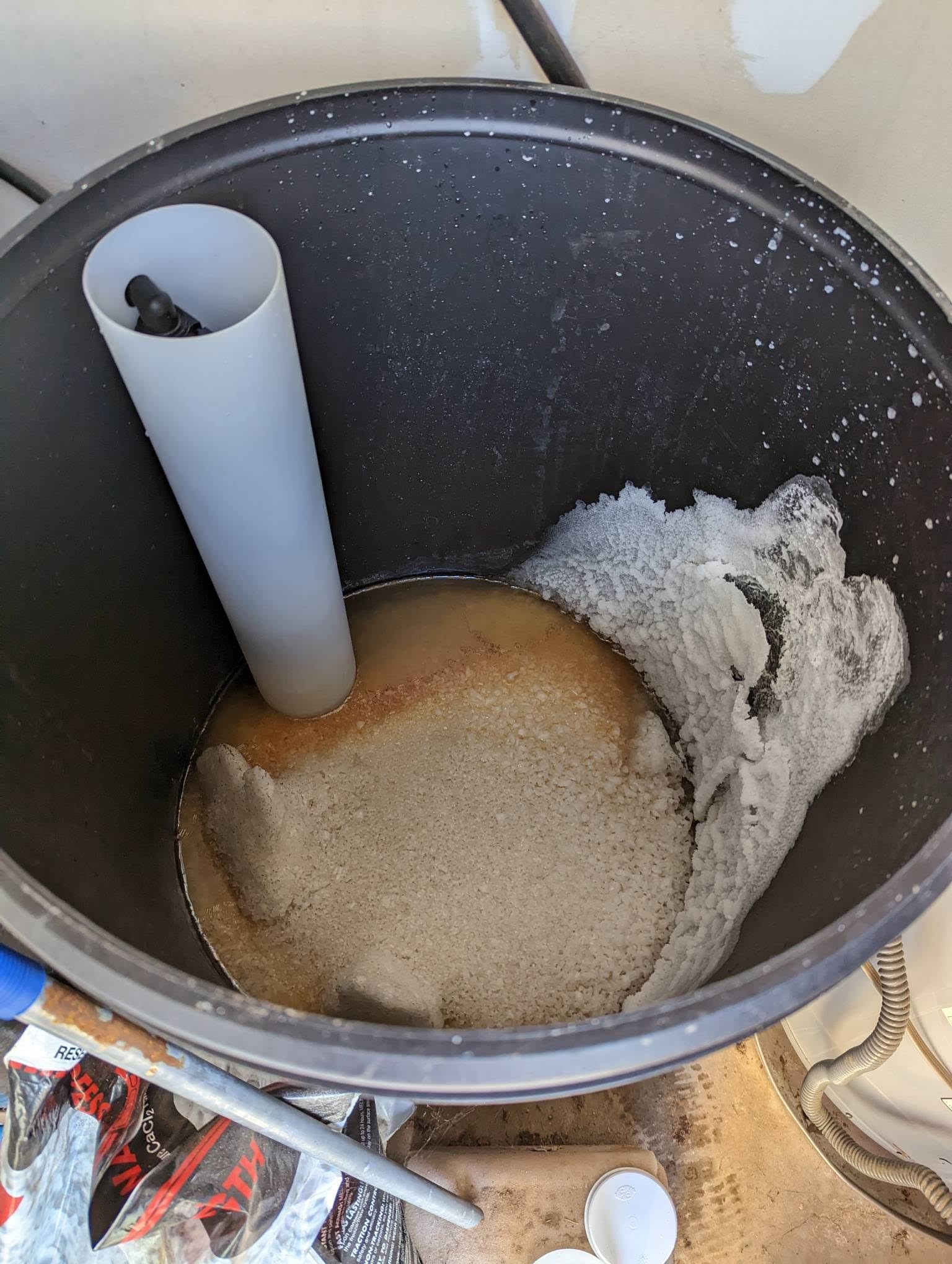

Speaking of salt, the salt turned orange while not being used for 2+ years. I'm assuming that's iron/rust? Remove/replace the salt or throw in some iron out or better iron salt?

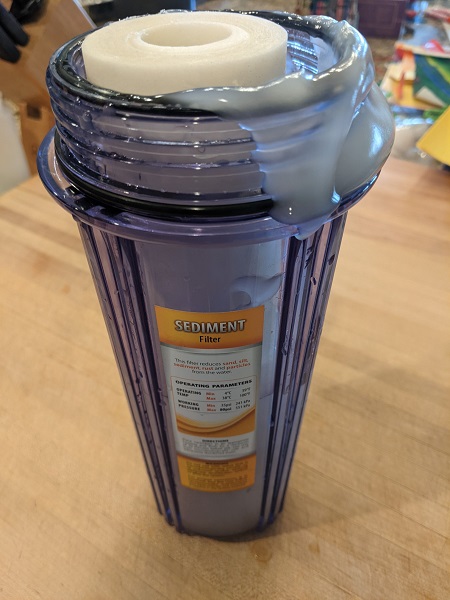

Oh and this was in our first stage sediment filter back around the time right before I switched into bypass mode.
It was slightly pondy tasting but reminded me more of chalk, slightly gritty in texture. Was this resin goop? Calcium? Algae? Notice how half the filter container was filled with this junk. Ugh.

If you want to try it, remove all that old salt and throughly rinse out the bin. Fill it with water and iron out and do one or two regens with iron out. After each regen run the cold water at the tub to throughly rinse out any rust that may have been left behind. If the water pressure seem OK, fill it with salt and run a regen.

The appropriate tank size for 2 ft3 resin + gravel under-bedding is 12" X 52" which will provide sufficient freeboard space to expand and reclassifying the resin during each regeneration cycle. Many online systems do not include gravel since gravel is heavy and because shipping costs are included within the purchase price, online dealers often claim gravel is not necessary so as to not only save the small cost of gravel, but mostly to reduce the shipping expense. Since those systems do not include gravel, to further reduce the dealer's costs, the resin tank size will be often reduced to 12" X 48" which will further reduce the shipping expense in addition to the cost of the tank itself.
For your 12" diameter tank, 20 lbs of 1/8" X 1/16" bedding gravel is appropriate. To provide the necessary 50% freeboard space, recommend installing no more than 1.7 ft3 new 10% resin. Better still, if a backwashing carbon filtration system is utilized to remove chlorine/chloramine, chlorination byproducts and other contaminants before the softener, then standard 8% resin maybe utilized.
Since most North America produced softener resin is available in both 1 ft3 and 0.5 ft3 bags, and as 1.7 ft3 is not a standard quantity, you could utilize 1.5 ft3 (Total 48,000 grains hardness removal capacity) to re-bed your system.
To obtain higher efficiency to provide high quality soft water, the usual recommended salt setting is 8 lbs per ft3. With 1.5 ft3 resin, that will require 12 lbs salt to regenerate 36,000 grains usable capacity per regeneration cycle.
Previously, when fixtures were less efficient, water consumption had been estimated at 75-gallons/person/day. Now, due to low flush toilets and higher efficiency plumbing fixtures and appliances, 60-gllons per person per day is usually utilized for estimates, so your 67 gals/p/d is not necessarily out of line.
36,000 gr / 3484 gr/day (67gal X 4ppl X 13 gpg) = 10.33 days - 1-day reserve = 9-10 days estimated regeneration frequency.
Because your chlorinated municipal water will not contain iron, the usual recommendation is to size the system for regeneration to occur between 1X/week to 1X per month so 9-10 days will be appropriate.
Hmm your sediment filter is AFTER the water softener ("resin goop")? It should be ahead of the softener.
You say you had great pressure initially but then...clog somewhere? This sediment filter???
It's a 5 stage RO system in the kitchen to a single faucet for drinking/cooking water. Sorry that it wasn't clear. I have no pre-filter before the softener.
I'm just wondering if the white goop might be related to the softener issues. Probably more likely related to maintenance since I hadn't changed the RO filters in ~2.5 years (oopsie!). The water tasted a bit 'off' from the RO faucet. However the wife is the only one that really uses the RO drinking water and she doses her water bottle with a magnesium supplement so I think it masked the off taste and smell or we would have noticed the "goop" much earlier.

Flush the sediment out of your water heater. Not related to your current problems, but while you are in maintenance mode, good idea.
I don't know what that goop is. Water heaters can sometimes generate that, but water does not go from your WH to that filter. Maybe your water department could have a clue, because they use some additive?
Do dump the old contents of your brine tank into a garbage bag. It's time for that too.

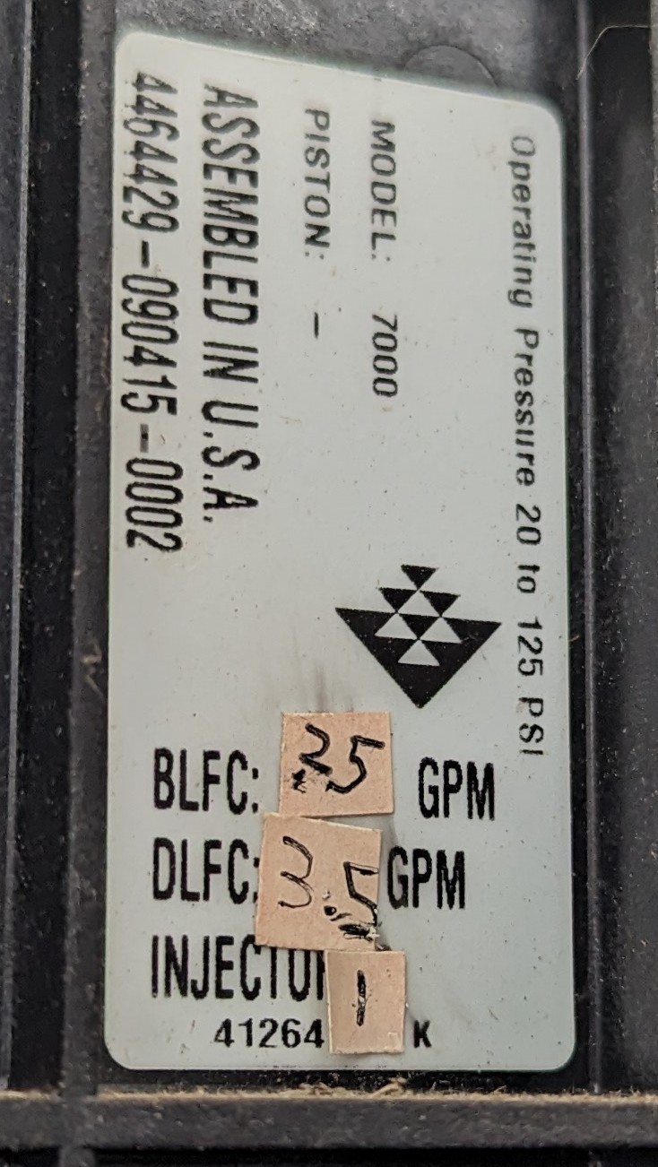

Couldn't start up the new tank though cause it came with a 1" tube and the Fleck 7000 needs a 32mm tube (1.25 inch). I ran down to the big box store only to find out 1 inch PVC isn't the same thing, blargity blarg blarg. So here I am ordering a $40 32mm tube off the internet that'll work with my 7000 and my new 52" tank.
Does someone have a dummies guide to programming the 7000 with the new specs? Need ~3500 grains per day, 2.0cf of 10% resin. Here's the only label I could find on the valve. Was that from the factory or the 3rd party vendor that sold me the unit?

Need ~3500 grains per day??? what is that in gallons, maybe 270? The 7000 has a mode where it learns the needed reserve. I will assume you will use that mode.
Here is setup info based on an older table:
System info (not programmed)
salt lb/cuft : 8 ; A choice ( efficiency vs capacity)
BLFC : 0.25 ; Brine Refill rate GPM
cubic ft resin : 2.0 ; Same as (nominal grains/32,000)
Raw hardness : 13.0 ; including iron etc
Estimated gal/day : 270.0 ; 60 gal per person typical calc
Estimated days each regen : 11.4 ; presuming days each use reserve capacity
Fleck 7000SXT Settings:
DF = Gal ; Units
VT = dF2b ; Downflw/Upflw, Double Backwash
CT = Fd ; Meter Delayed regen trigger
C = 48.0 ; capacity in 1000 grains
H = 16 ; Hardness grains after compensation
RS = cr ; Cr = base reserve on recent experience
CR = 0 ; 0 is default (leave it)
DO = 14 ; Day Override (typ 28 if no iron/Mn)
RT = 2:00 ; Regen time (default 2 AM)
B1 = 8 ; Backwash 1 (minutes)
Bd = 60 ; Brine draw minutes
B2 = 5 ; Backwash 2 (minutes)
RR = 6 ; Rapid Rinse minutes
BF = 21 ; Brine fill minutes
FM = t1.2 (usual) ; t1.2 is default flow meter
Here are alternate numbers
The less salt per cubic ft, the more salt efficient, but more hardness breakthrough.
BLFC = 0.25
cubic ft resin = 2
Alternative C and BF pairs:
lb/cuft ; C= ; BF=
5.250 ; 37.2 ; 14
5.625 ; 38.6 ; 15
6.000 ; 40.0 ; 16 #good choice for less salt usage
6.375 ; 41.5 ; 17
6.750 ; 43.1 ; 18
7.125 ; 44.6 ; 19
7.500 ; 46.1 ; 20
7.875 ; 47.5 ; 21 #good choice for less hardness leakage
8.250 ; 48.9 ; 22
8.625 ; 50.2 ; 23
9.000 ; 51.3 ; 24
9.375 ; 52.4 ; 25
9.750 ; 53.4 ; 26
10.125 ; 54.3 ; 27
10.500 ; 55.1 ; 28
