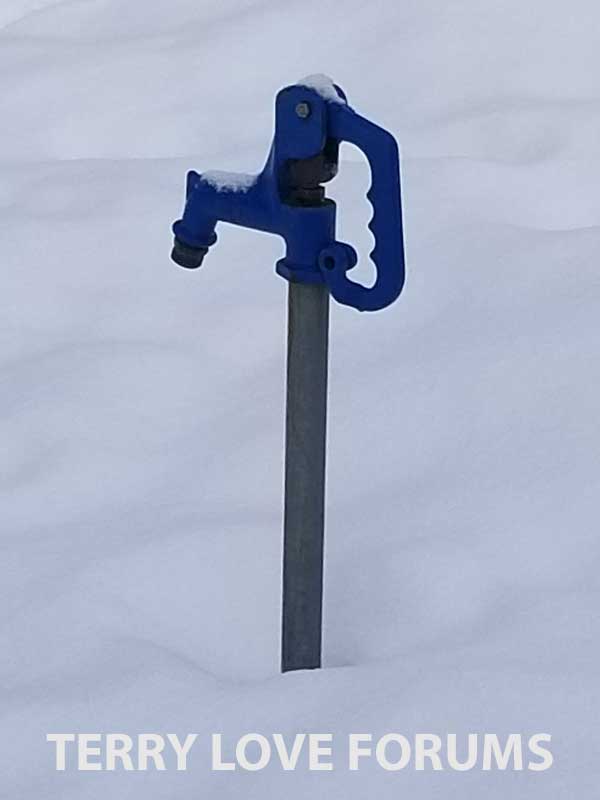

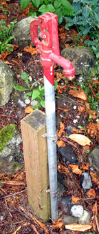

So I take it that there is a vacuum breaker for the irrigation, the yard faucets off of those lines.
PVC or poly in the ground would be fine, though for the risers I can see using galvanized for the faucets. Sometimes with yard hydrants I've used wood post to make them more sturdy. The one on the right, in Seattle without the post.
I saw this one in Leavenworth WA
