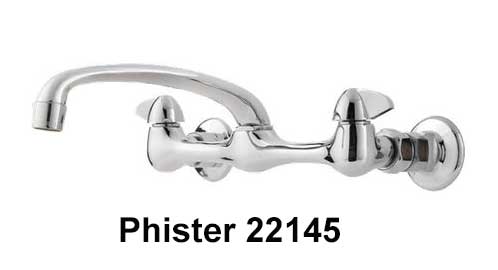

Pfister
Pfirst Two-Handle Wall Mount Kitchen Faucet in Polished Chrome
SKU# 22145 | MODEL# G127-1000
Our Price: $97.00
Sale Price:$60.92
In Stock
Delivered to your door in 5 days or less.

If you go on E BAY there are a lot of venders selling all types of faucets and regarding the aerator it can be easily removed or the flow restrictor taken out.
Here a faucet brand new SKU# 22145 | MODEL# G127-1000 is $60 now think how much your time is worth
How much for the seats and spindles to fix something that looks like hell and the O rings and packing are brittle
If your lucky you can usually use the same conections from the back to the new faucet and to change out takes less then 10 minutes
