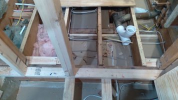

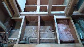

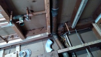

Hi Wayne,
The 3" copper vertical is a vent and also picks up the double vanity (do no think you can see it in the pic) so it is a vent but also a drain which is why I believe I cannot reduce to a 2"

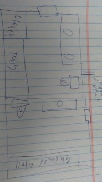

I attached a layout of the old and new bathrooms I hope explains the end result I am trying to get to.
I also have pictures of the area I have to work in from the old bath facing the new and from the new facing to the old. The framing is not done yet but there will be a wall between the two rooms.
You can see the vertical drop in the main and the old flange and 90 I cut out just under the plywood.

That last photo makes it looks like the 3" combo would fit, with a 3" spigot end closet flange that fits directly into the 3" hub. What's the elevation of the top of the hub relative to your finish floor elevation? And does the barrel of the combo have the correct 1/4" per foot slope?
For the 3" copper vertical, if it's only carrying two lavs, you could downsize it to 2" no problem, possibly 1-1/2". You might want to consider the whole house DWV layout to see if there's any reason to have a 3" vent there, but the IPC, in use in CT, would never require a 3" dry vent on a normal house.

the combo actually is over 2" (2 1/8th aprox) above the floor joist. i should have shown that in a better angle.
hmm interesting I did not think CT would allow a reduction in that vent but making that a 2" from where the vanity ties in down would help but not sure I can get that combo low enough to not stick out past the floor height even after the 3/4 ply , durock and ties are installed.
and the toilet flange would then be about 13 1/2" from the wall.
