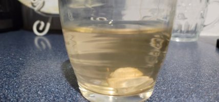

The two units regens do not overlap. The test showed no iron the day after the test but does show a slight amount on the last day. The unit regens every 3 days. As previously mentioned I see brown water day after a regen if i add chlorine to a sample taking directly after iron filter. I even added iron out to the sample the chlorine turned brown and it made the water turn clear again. So i assume it is iron. I tried to regen a couple times manually in a 24 hour period with same result. The tank is blue so I do not think I can see in it with a flashlight. The softner serves the entire house I am positive about that. The valve is a 5800 xtr2 touch screen.

The chlorine is turning water brown even after a regen is this Iron or Iron bacteria and if so why would my water guy say my water showed no iron. And more importantly what should I do. I am frustrated with constant toilet stains of rust colored streaks.

Below is a picture of a water sample after going through the iron filter that I added a chlorine tab to
