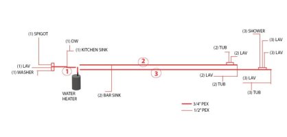

Timberwolf78
10
Minnesota
Hey again
So I created this new iso just depicting hot water supply, that may help explain things better.
I marked 3 main trunks as 1, 2, 3.
Trunks 2 and 3 run in parallel right next to each other that go appx. 50-55 feet from the mech room all the way to the other end of the house. Each trunk serves 2 bathrooms (total of 4 baths)
The kitchen, that is served by trunk #1 is right above the mech room.

Jeff H Young
9,792
2,476
92346
great You might need to go overthat with your plumber to make sure you are both on same track .
Timberwolf78
10
Minnesota
I am the plumber now :)
I have most of the pex lines roughed in.
What I am trying to figure out is how to run the recirc lines based on my setup. something that is the least complicated with the least amount of moving parts(mixing valves) ideally.
Since it's new construction and walls and floor trusses are open, I am ok with any amount and size of pex that I would need to install.
1. run recirc lines back to the water heater for each of the 3 trunks - so 3 separate lines -
(it would be 3 half inch lines connected to mixing valves at the heater?)
2. run 2 lines each for trunk #2 and #3 but leave #1 since both the kitchen and laundry are like 10 feet from water heater.
(2 half inch lines connected to mixing valves at the heater?)
3. connect #2 and #3 where the bahrooms are and run 1 line back to the heater.
(If I go with this option, should I use a 3/4" or a 1/2" pipe?)
or something else?
John Gayewski
4,985
1,604
Iowa
or something else?
Third option. Use 3/4" pipe to connect them.
Jeff H Young
9,792
2,476
92346
I think a single loop is better , 4 bathrooms Ive had it size out to a 1 inch main on the hot and that was copper so with pex you are probebly close and Im guessing 90 percent run all 3/4 but its probebly close to requiring 1 inch
