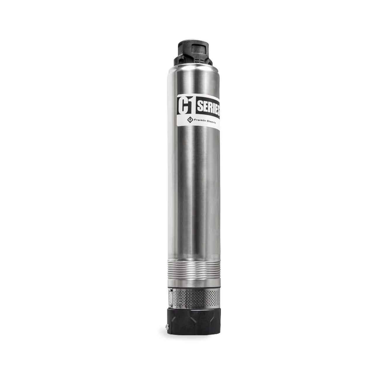

Well was drilled about 20 years ago using rotary mud drill. 12" casing. At about 40' of depth, the drill dropped 4' and all the water in the bore drained into the void that we hit. The void was filled with moving water. They could not get it any deeper.
We have 4' of water. When we pump, it pulls down a foot or more, but never sucks air. However, we keep on burning up submersible pumps. Too deep and they sit in the mud/clay at the bottom and get hot, too shallow and it seems the top of the pump gets out of the water and it overheats.
A few too many overheats, and the pump is shot.
A jet pump would solve this I guess. But we would have to construct a much larger and deeper pump house to protect from freezing.
We have a pretty large 12" casing. Are there any "short fat" submersible pumps that anyone knows of?

I would use a regular 10 GPM, 1/2HP , 230V submersible well pump. If you seal the flow inducer extremely well above the pump intake it won't suck air until the water level is several more inches. below the intake. Then I would use a ball valve to restrict the pump down to as little as 1 GPM if needed to keep it from sucking air. With the 230V model a Cycle Sensor could then shut the pump off if/when it did pump the well dry, and time how long before it lets the pump come on again.

You could also use a cistern submersible with the intake on the bottom. These are not as tough as the regular water well submersibles, but will get you a couple more feet before pumping off. With the 230V model you can still use the Cycle Sensor to protect it and restricting as much as needed is also advised.

The flow inducer will also keep the bottom of the motor out of the muck. If you get it too low it will just stop pumping water. Yes, sitting the bottom of the motor in the mud will cause it to fail. You would be able to see the muck line on the side of the motor if that was the cause of failure. When the pump sucks air it will just lose prime and burn up. You won't see any air in the lines. A Cycle Sensor will shut it off if it does suck air A flow inducer will keep it cooler and out of the muck. A ball valve can restrict the flow so it doesn't suck air. Your best bet is a combination of all three.
