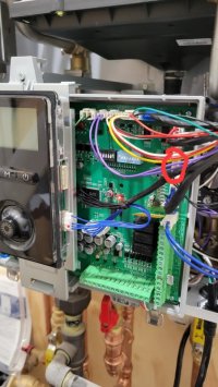

I recently had a new Navien NCB 240/130H boiler installed. I purchased the Navilink lite and can't seem to identify where on the unit to connect the 5 pin connector. The directions seem to point to the front panel display, but I don't see a 5 pin connection. Thank you in advance.

Take the front cover off. There should be a matching connector on the front panel inside the unit.

Here are some pictures. The only connection I see is an 7 pin connection. No five pin connection.

Gave it a second look after the cover. The proper 5 pin conector is there as well. It's further to the right. Not right at the controller.

Gave it another look. The correct connector is available. It's just a bit off to the side where a number of other connectors are. See the image.
