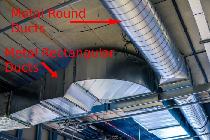

2. The plenum feeds two trunks that look very similar to this:
Font Rectangle Line Parallel Slope
3. The left feeds ~550 sq ft and is good for up to 950 CFM, the right feeds ~400 sq ft and is good for 950 CFM (the house is noisy with the HVAC running). Total 1st floor vent CFM is ~765 and I'm sure they're seeing more than that
