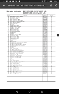

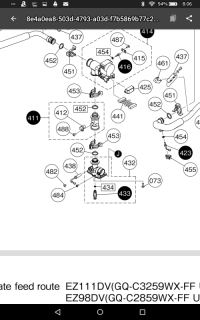

Might my Noritz tankless be misreading the flow rate?
Fitter30
4,403
808
Peace valley missouri
Flow control is read by a magnetic sensor item 412
411 is the complete sensor
