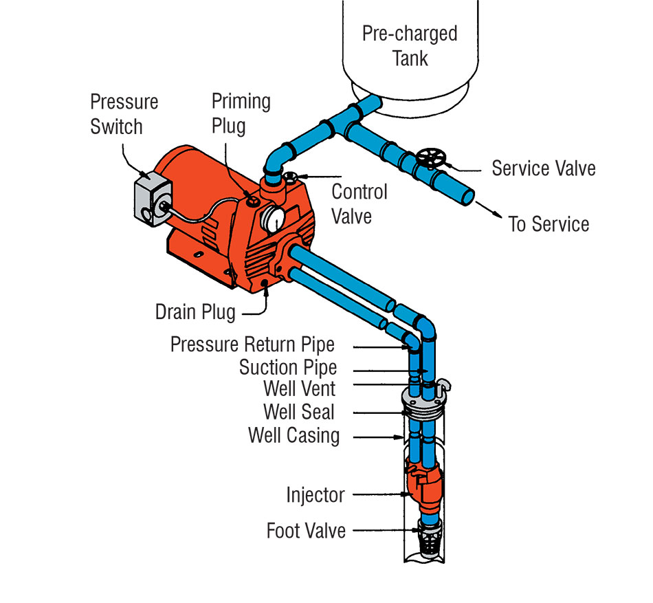

it’s a convertible shallow/deep water pump
When the distance between the water and pump inlet exceeds the vertical distance previously specified, then the pump would need to be configured as a deep well pump. This is achieved by removing the injector assembly from the pump, to allow 2 pipes to be installed. The 2 pipes would run the distance between the pump and the Injector assembly, which would be located within 20' of the water location.
The 2nd smaller diameter pipe is utilized to pump water down to the injector, so the pressurized water passing through the injector assembly will draw in additional water from the water source, and will propel the flow upward within the suction line, thereby permitting water to be pumped vertically from a greater distance before the jet pump.
Image below, shows a deep well configuration within a well casing.

Do you mean the top of the lake freezes to the shore, or, freezes all the way down to the bottom of that section of the lake? In the prior case, how is the suction line currently routed, and if the later, how is water obtained during the winter?
