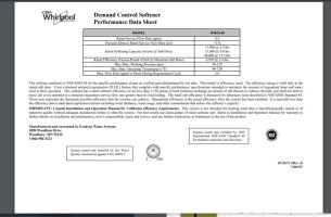

So cabinet softener may be in play for 5 years and gone. The ONE issue is if we get "stuck" here by the housing market tanking. I guess one could reevaluate at that time. In the whirlpool cabinet style I assume those are always 8% resin? Its harder to find stats on them but I did find a spec sheet. What's your opinion on the 8% vs 10% for city water? the big box offerings that info doesn't seem to be available.
I need to test the water first before even thinking about anything as it may be so hard that a cabinet just wont work well enough. I can tell you its pretty hard, central ohio, on the map were dark red. Our faucets have extreme build up in like a month and it just feels terrible on the skin. Off to the store now to grab a test kit.

If the maker/seller don't specify, I would not know what to guess.
