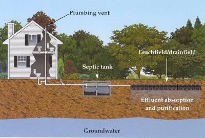

How To Add or Replace a Septic Sewage System
So you want to build a home in a rural area that will not be able to attach to city sewage OR the septic sewage system in your current home needs to be replaced.

Some info:
*A percolation test (often referred to as "perc test") is used to determine how well the soil will absorb and distribute water. If your soil does not percolate well, the water will not dissipate quickly enough. In some places this needs to be done by the health inspector or designated person. In others you can do it and the inspector will check it.
*The septic tank must be at least 10' from the house.
*D-box= distribution box. If you need more than 2 runs of leach line, you will need this to equally distribute the water to each line.
*The general incline needed for the field line is 1/4" per ft. The lines cannot be more than 100' each and cannot drop more than 1' in a 100' run.
*Make sure you plan your field line to be in a place that will not be driven over frequently (if possible). You most definetely want to make sure that the sewage sucking truck is not going to drive ove the leach field lines. In some cases, this means you may need to have a run of thick pipe connecting your leach lines. The pipe should be able to be driven over every once in awhile. Certain types of leach lines can be driven over with a tractor or small vehicle so long as it does not compact the soil and you can only have it run across (perpendicular) and not along the run.
*Generally the leach field will be covered in no more than 12" of soil. This is so the soil will not be compacted too much to allow water to pass through it.
*The soil under the leach line should NOT be tamped down and compacted.
