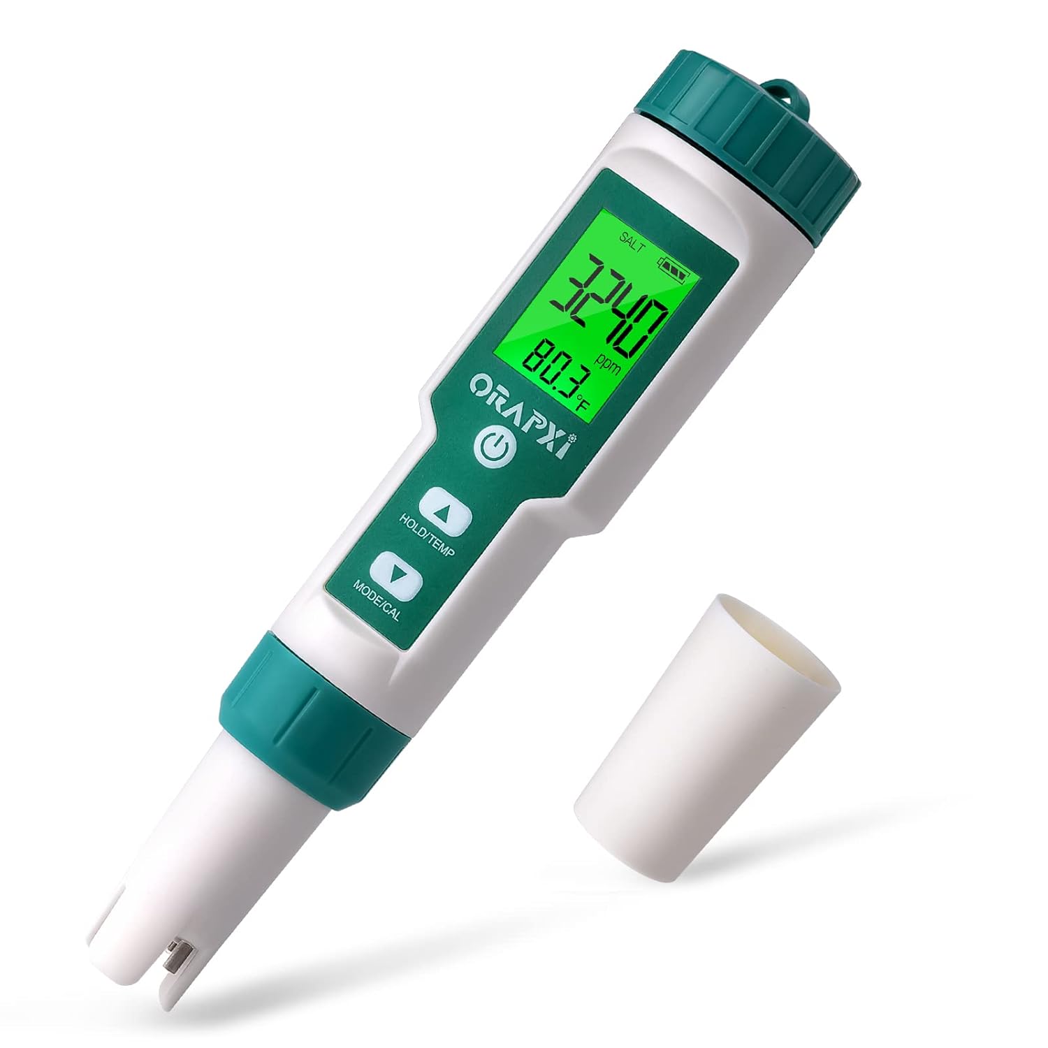

Are you using both a cheap TDS meter and a refractometer or other method to measure TDS and salt?
FCJ
Oregon
Evaporation? Evaporation increases TDS and salt concentration.
This is what I'm currently using, I'm not aware of anything else besides test strips I should be trying.
41,399
4,995
That's fine. I thought maybe you had something extra/fancier.
