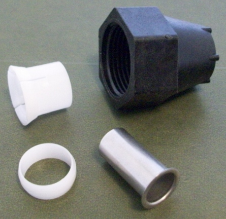

Does anyone know where I can get these fittings to connect new water lines? Are they expansion or push on? Can I connect a water line with crimp on this? Thanks for all the help.

purchase manablock nut, insert stiffener and lock-in insert, and ferrule, all required per joint
try local hydronics suppliers

Would I be able to use this? Nobody has those compression fittings.

Manabloc fittings are insert fittings also, not expansion. The op should use a swivel version of that fitting.
