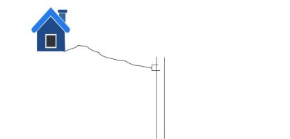

Morning all. First post here, long time reader. Thank you all for all the help and information you have already provided me.
I live up in the mountains of CO at 11000 ft and unfortunately came back from a trip to find my cistern not filling.
I have a submersible pump at 365' depth, filling a 400 gallon cistern in the basement.
The pitless adapter is probably 6-7' deep, and the underground line is approximately 175-200 ft of 1/2" copper.
I had a well tech install a "drain back" in the system this summer, as the cistern is top fed and the line that fills it allows air in. When it was installed this summer he turned on the pump, and then turned it off and confirmed he heard it "sucking" the water back towards the well.
But apparently it is not pulling all of the water out of the system as there is water freezing somewhere between the house and the pitless.
I had a welder come out Monday and we thawed the lines out, cistern filled up and wasn't calling for anymore water, and the line was frozen again by Wednesday.
Was wondering if anyone had any suggestions or solutions that had worked for them? Maybe the drainback needs to be installed deeper (Im guessing some of the copper line runs up hill from the house to the well which is causing that water to get stuck in the line and freeze)? Is there not enough air in the cistern when full to allow it to siphon the water back into the well?

Any low spot in that line may hold water and freeze. You may need a larger or more drain back valves. If it drains back fast enough it will create a siphon and suck out even the low spots. Won't happen if it drains back slowly. I would say to just take the check valve out of the pump, but at 300' deep the pump would spin backwards like crazy. You could probably drill maybe a 1/2" hole in the check valve, which would let it drain back faster and maybe not spin the pump.
Other than that they make some heat trace or heat tape that can be slid inside the pipe, but I don't know much about it.
If the output of the pipe to the cistern is below the water level, that could complicate things. If you could, you would know there is a belly. I guess you already know there is a belly, but you would like to know where and if your attempt of a fix was successful.
How did the welder thaw your pipe? Put a current through the whole length to generate heat?
You might be able to rig up a test to see if you can pressurize that copper pipe to 0.25 psi of air pressure in a static state.
I am thinking about a system where you compress air into a tank while the pump runs, and releases that air on the pump side of a new check valve when the pump turns off. I am not a pro.

Yea the welder hooked up 170ish amps to the line and it defrosted in 30 mins.
I also had the idea of some sort of pressurized blow out, not sure how I would automate it though.
Hoping as Cary mentioned that if I can make the flow of the drain back high enough it will pull back through that that low area (is belly the technical term for that?)

Let's muse on that. One thought is to have a timer relay that triggers when the pump turns off. It causes power to be delivered to a small compressor that blows into the well side of a check valve for a programmable amount of time. https://www.zoro.com/search?q=timer relay I have not used such a device. If the power switching ability of the timer relay is not high enough, have the timer relay control a power relay (AKA contactor).
Another idea is that if you think that your copper pipe is sloped properly the whole way, except for one belly, somehow locate the belly, and fix it.
I presume trenching a new line below the frost line is out of the question.
So here is an idea for a test. When the weather is warm enough, see how much pressure it takes to push air thru your pipe. You could make your own fixture to let you blow into a tee. Maybe have a valve on the port that you blow on. Another port feeds the long copper pipe.
That third port of the tee has a clear plastic tube that you place in a glass of water. Before you blow, the water level in the tube is pretty much the same as the water in the rest of the glass. As you blow, and the belly resists air flow, the water in the tube falls below the water level in the rest of the glass.
Now if you find that the pressure cannot sustains, but the pressure with time falls to zero, then there would seem that there is no belly. And having your in-well drain simply drains too slowly.
So in other words, is there a belly, or does the drain-back valve not drain fast enough.
Here is another idea, which may be worthless. Suppose you push a small tube from the port at the tank. You apply low pressure or vacuum, and detect when you hit water. You now know where the belly is, and you dig.
I think that compressor and timer relay has the most chance of successful implementation.
And here is a variation: If your tank can go a day or more without the well pump running, you turn off that pump in cold weather. Then when the tank is low, you go to the well house, and turn on the well pump power. When the pump shuts off, you turn off the power again. You blow air down the copper pipe to clear the water. This would be workable if these cold snaps are fairly rare.

Thanks Reach! I appreciate all the insights, you clearly like problem solving as I do.
I have my doubts as to if the copper line is sloped properly all the way, it looks like it should be until just before the house, if I were to guess, it looks something like this terrible drawing of mine, sloping mostly downhill from the house to the well, with the exception of just outside the house. Looking at the layout of my yard, I think there is a bit of an uphill section leaving the house before it makes its gradual downhill all the way out to the well. My guess (and its just that) is that it is freezing somewhere just outside the house, in that section that comes up a touch. The side of my house that the well line is coming into also has no snow, so without the insulation from the snow, I'm sure the frost line is even lower.
Reading Cary's ideas, I am hoping that if I increase the rate of drain back, the siphon would be strong enough to pull it out of that section. That would seem to be the easiest way out of this problem. You think a strong enough drain back volume would be able to pull the water up out of that section?
If not, I think the timer relay and compressor will be my best move. The tank calls for water frequently enough and the cold is so persistent here that a manual blow out would be a pretty big pain.

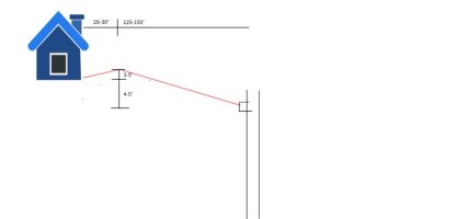

I am now just wondering why it is not pulling all of the water back to the well, and how to make it do so. If you look I in the post above I just a moment ago posted a drawing of what I would guess the line to my house looks like. Potentially a little bit (20-30ft) of uphill leaving the house, before a long 125-150ft downhill to the well.
Without knowing how the drain-back is setup, if at the well there is a drain-back valve that only opens if the pressure is less than 10 PSI, that much elevation would apply (0.43 X 150 = 64.5 PSI of static pressure just from the weight of the water so a drain-back valve would never open. If the drain-back is a hole drilled in the pipe, the size of hole determines how fast it drains back and whether the water would have enough momentum to get sucked out of a belly in the line.
Sorry LL, I should have clarified what I meant, by my estimation there is a probably 20-30ft length of pipe from the house that probably goes up 3-5 ft to the high point in the line, and then a 125-150ft length of pipe from that high point to the pitless, which is probably 7-10 ft drop. Hopefully this drawing makes more sense, the line from the pitless to the house in red.
So with only that 7-10' ft drop from the high point to the pitless, I would think I wouldn't see more than 4.3 PSI (10*.43) pressure at that drain back, and because the tech heard it siphoning back to the well, I'm guessing that that the drain back valve is opening, but there is not enough suction to pull the water out of that section from the house.

The pipe is always open at the top of the cistern, and always above the water line, the float valve in the cistern shuts off the well pump before the water line would ever reach the opening of the line.
This is way different than what we were thinking. We were thinking that a float switch in the cistern controlled the well pump.
If you have a float valve, that would block air.
So describe the setup, that brings water to the cistern, better.

Sorry, i am an idiot.
I meant to say I have a float switch, not valve, in the cistern controls the well pump.
My bad.
