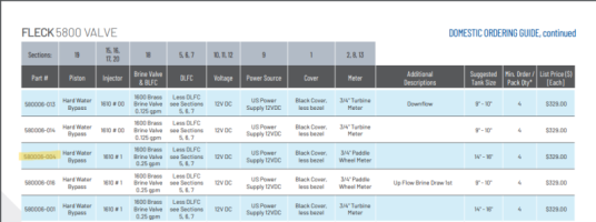

A new install by a dealer on I used on Yelp, installed a Upflow 2.5cu ft catalytic carbon and a Fleck 5800 SXT 2.5cu ft 80k water softener. From what I understand trying to learn from several post. I am having trouble with getting my water to be "soft / slippery". When it was first installed and running, the water felt very slippery / taste clean and mildly sweet. Now after a month, it lost its softness. I checked the SXT settings and of course, all were default settings, never programed.
So after Programming, running a regeneration cycle, it still does not feel soft, but regular tap / slightly salty.
Sticker Found under my SXT model
Sticker on brine line states Injector #1 and 0.25 GPM.
(From Manual) Pentair Serial #: 580006-004 - Paddle Wheel Meter, Downflow Softener, U.S. Power Supply, #1 Injector, 0.25 GPM BLFC
(Attached is ordering guide for SXT 5800 models)
My home main waterline PSI ~90, with post bibb ~85 PSI
5800SXT System
City Water
salt lb/cuft : 8.0
BLFC : 0.25 GPM
cubic ft resin : 2.5 / 80k
Raw hardness : 22.0 (compensated 1.12 / no iron)
Estimated gal/day 300.0 ; 60gal/person
Est days/regen ???
Fleck 5800SXT Settings (Current):
DF = Gal ; Units
VT = 5800 ; Valve type
RF = dF1b
CT = Fd ; Meter Delayed regen trigger
C = 60 ; capacity in 1000 grains
H = 22 ; Hardness grains after comp factor
RS = cr ;
DO = 14 ; Day Override (typ 28 if no iron/Mn)
RT = 3:45 ; Regen time (default 2 AM)
Bw = 10 ; Backwash 1 (minutes) [3...10]
Bd = 60 ; Brine draw minutes
RR = 10 ; Rapid Rinse minutes [5...10]
BF = 27 ; Brine fill minutes
FM = P0.7 (3/4 paddle wheel downflow)
1st force regeneration, I have tried dF2b, C = 80k, B1 = 5, Bd = 60, B2 = 5, RR = 10, BF 27 resulted the water to be extremely salty.
2nd force regeneration, I followed that with a dF1b, C = 60k, BW 10, Bd = 60, RR 10, BF 27 resulted tap water consistency.
Much help appreciated! Thank you.

Are you sure you have a paddle wheel and not a turbine? Since you cite the part number, I expect you are right on this. Is your countdown number decrementing by about 300 gallons per day?
Where did you get your hardness info?
This is similar to what you have...

Attached is photo copy of the model # and actual unit. I assume its a paddle wheel based on Model # sticker found under the unit and referenced it with the manual. I used another water softener ordering guide to confirm the size of the paddle being 3/4" paddle since the manual does not describe the size.
Countdown, I am not 100% sure, because currently it looks like its going in reverse the following day. (1818 to 1989) Not sure if its because I chose RS = cr and adjusting the variability.
My hardness info was attained from my city annual quality water reports. Ca 102ppm + Mg 18 ppm + Fe 0 = 329 mg/L or 19.2 grains. I factored from previous forum post an additional 1.12 resulting 21.5; ~ 22 grains.
Would increasing rapid rinse improve the salinity I am experiencing after regeneration? Or increasing the BD to 68 is the main culprit?
Stupid question, can you use the water i.e. shower while its regenerating? From what I believe so far, the water is being bypassed during regeneration, so you're receiving un softened water.

1. I don't think all 5800sxts offer RS = cr. But if you do base it on experience, yes, the number can go both up and down.
2. The part of the BD time after the brine has all been sucked out is considered the slow rinse. The water moves through in a laminar (smooth rather than turbulent)flow. It is more water efficient than the fast rinse, which is turbulent. With turbulent flow, the water is getting mixed up as you are rinsing. So I would prefer the longer BD time, which uses water at about a 0.35 gpm rate vs fast rinse at 4.0 gpm with a 13 inch tank. If you still detect salt after raising the BD to 68, going to 80 minutes would not be a problem.
3. As you are thinking, during the cycles, other than BF, the valve puts itself into bypass. You have hard water available during that time. So good for flushing the occasional toilet visit, but not as good a time for taking a shower usually.
4. Yep, paddlewheel.

That is a paddle wheel flow meter so the FM=P0.7 setting is correct.
Municipal water will be typically obtained from multiple sources. The hardness numbers each municipality report are usually an average from all sources. Since your home maybe located closer to a water source with higher hardness than average, hardness should be tested at your location, using a titration type total hardness test kit such as the Hach 5B.
Because municipal hardness will often vary due to distribution system maintenance, fire hydrant usage and time of day water use, it is advisable to program your softener hardness setting at 3 GPG higher than the hardness level determined by onsite testing.
