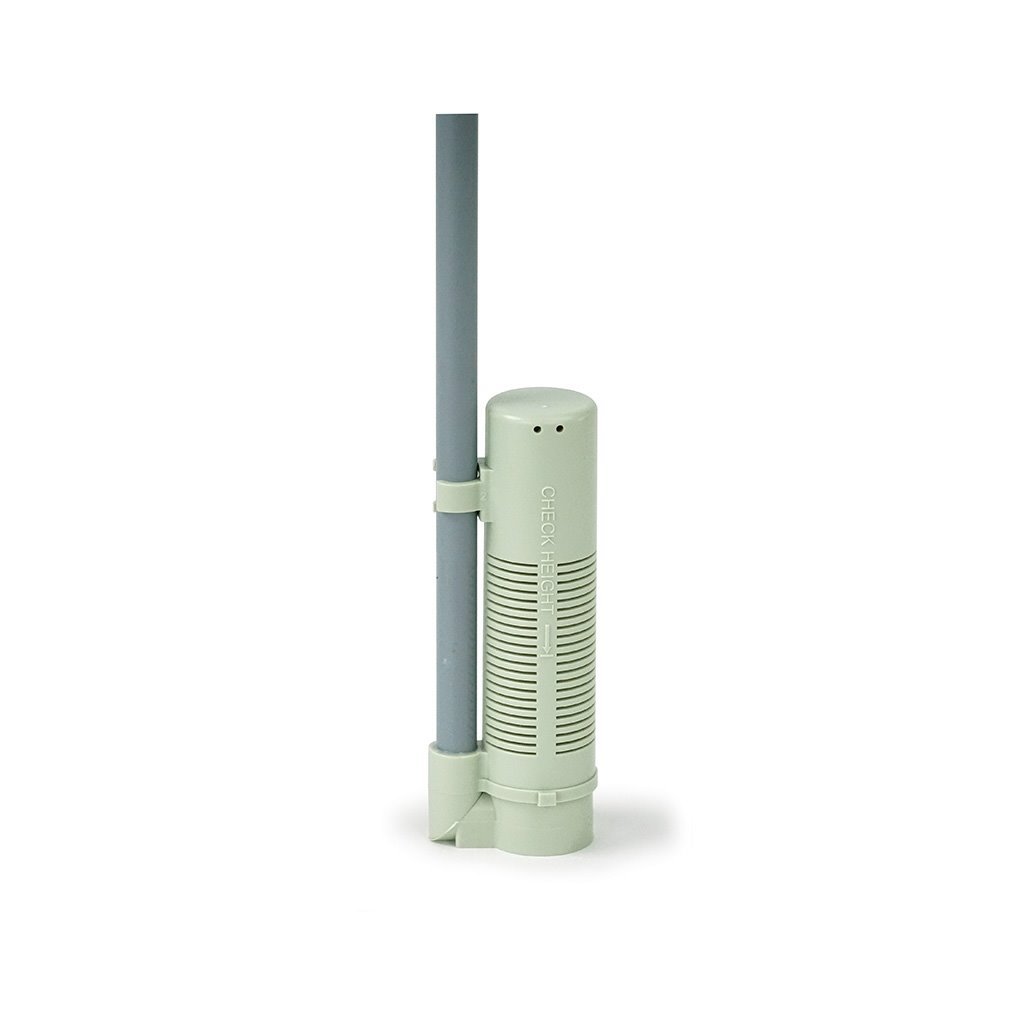

Once the majority of brine has been drawn out from the brine tank, the 'air check' valve located at the bottom of the brine pickup tube within the brine tank, will close to prevent air from being drawn into the resin tank during the Slow Rinse cycle. If the air check valve cannot fully close due to debris or foreign matter becoming stuck in the valve, then air will be drawn through into the resin tank, which can then enter the plumbing system once the regeneration cycle has concluded.
You could initiate a manual regeneration during the day while you are present. This will allow you to monitor the regeneration cycle, to determine if you can hear air being drawn into the air check screen once the remaining brine level is low. If air is entering through the air check valve, the brine pickup assembly will need to be removed from the brine tank, to allow it to be flushed with pressurized water from a garden hose nozzle, both externally and internally.
Here's a photo showing the air check screen which contains the air check valve:
