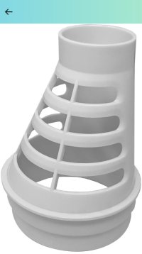

Thanks Reach4. Would this freeze guard be similar to a vacuum breaker? I would place it where it first exits the rim joist/siding before directing it into a pitched 4" PVC pipe that'll be run underground. .
Discharging right to daylight could also be an option as that side of the cottage isn't utilized for foot traffic or anything.
I would put the vacuum breaker at the high part of the pipe, but if we presume the pipe thru the rim joist is horizontal for a ways, I am not sure which end of the horizontal I would put it in. You want a siphon to empty the pipe, so I am thinking more interior. I am not a pro.
Example of what I was thinking:
I don't know how strong the vacuum has to be to open it.
An AAV could work too, but I am not sure how much pressure they are able to take.
Your freeze guard gadget does not seem so good to me. I would like the pipe to be able to flow, even if there is some initial backpressure.
