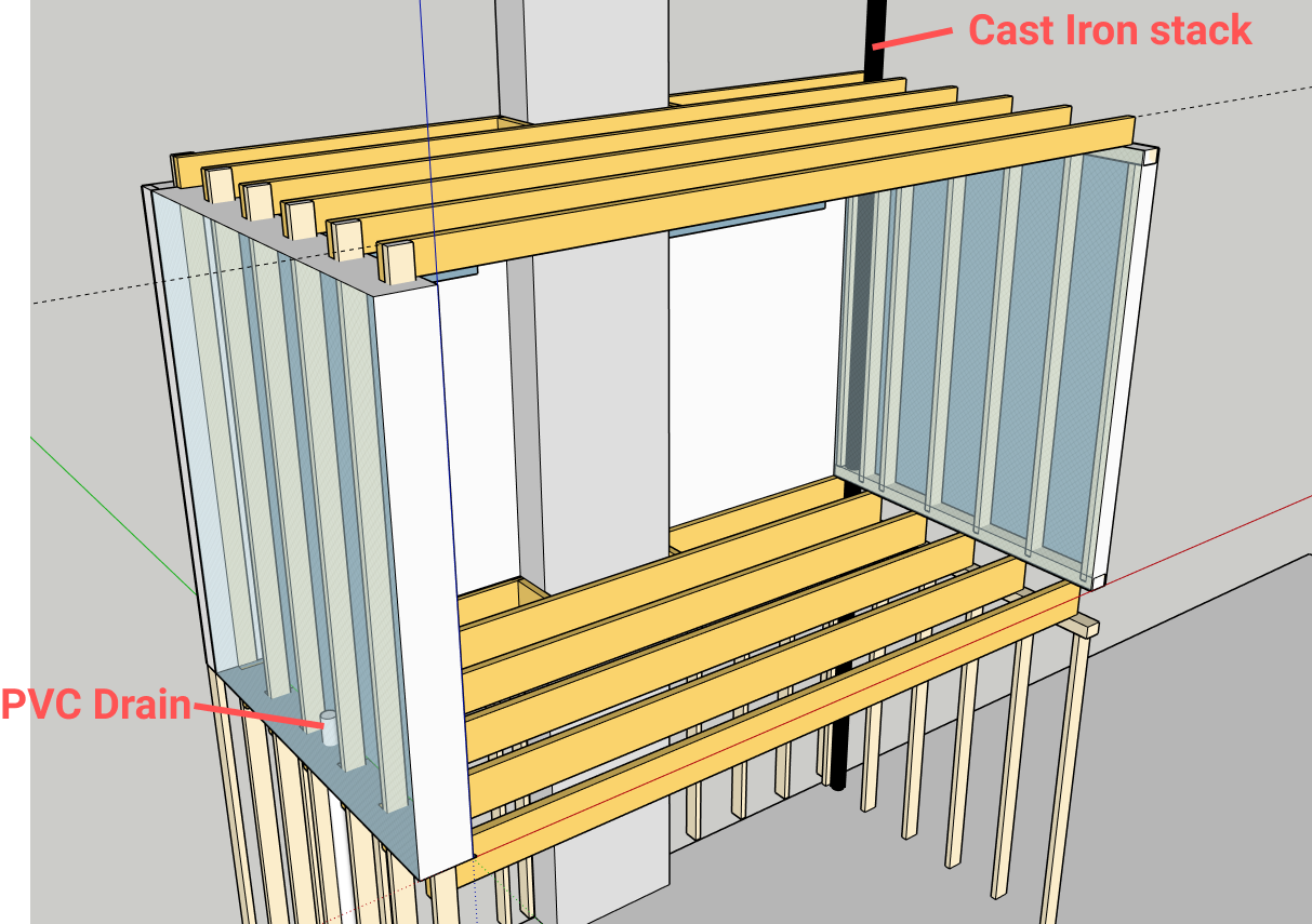

OK, so some more information is needed: first, a floor plan showing the floor joists and the "existing drain" and the "existing cast iron stack," along with the wall below that is the next bearing point for the floor joists . Also, what size are the floor joists? And the existing cast iron stack, is it the vent for any fixtures on the floor below, or is it just a drain for second story fixtures? Your photos show a cast iron san-tee in the floor system.

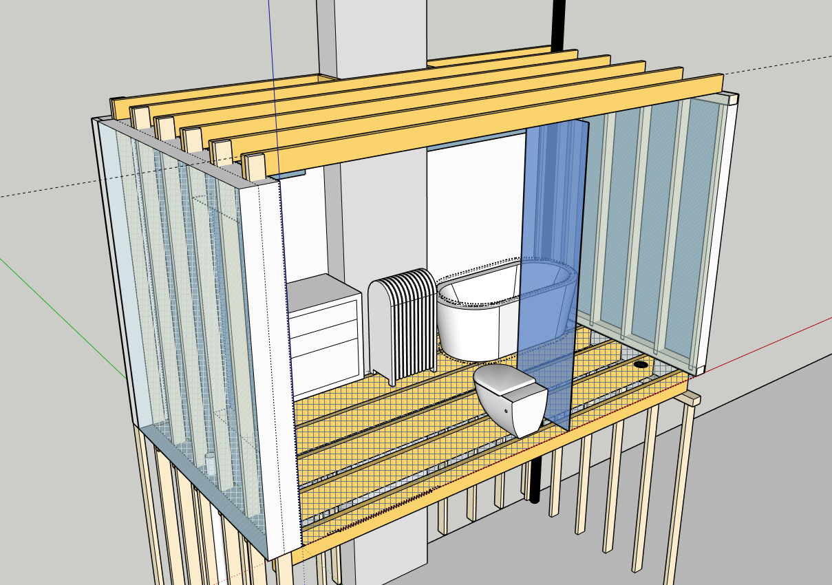

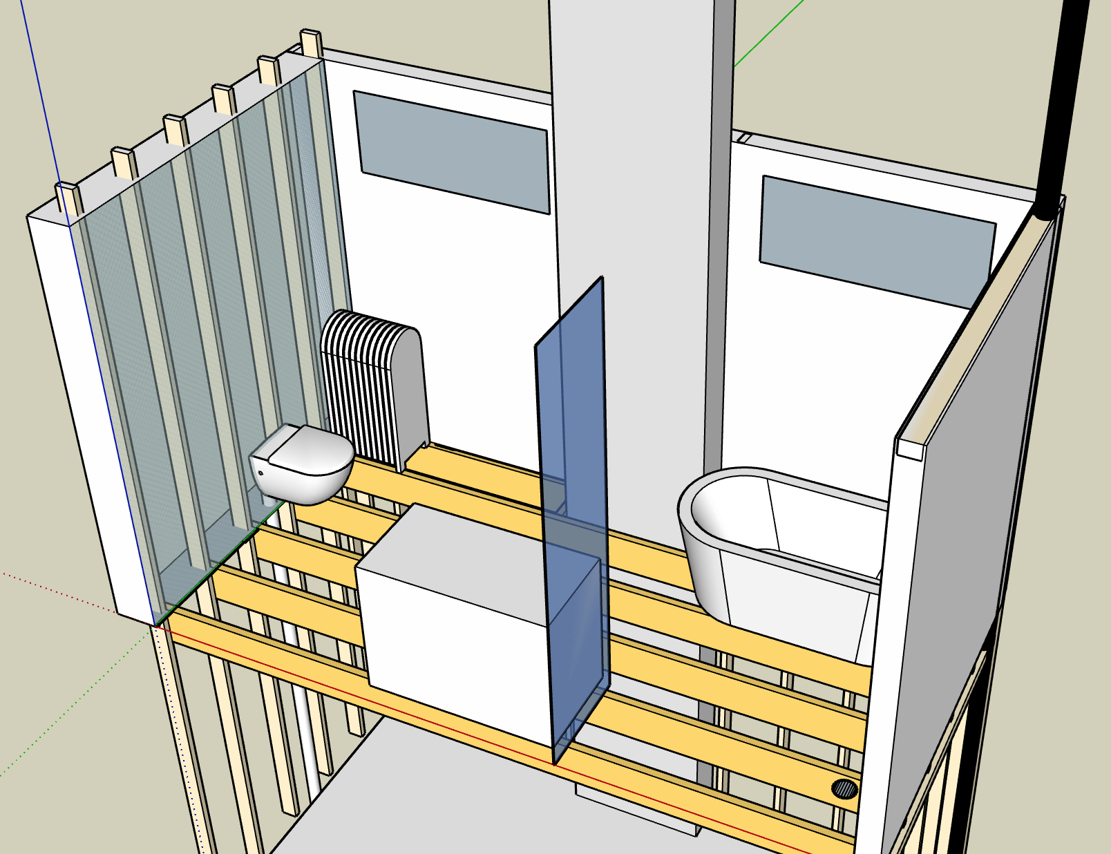

Here's the general joist layout. It's the second floor, living room below, attic above. Floor joists are 1.75 x 9.25 x ~13'. It's balloon framing, joists are nailed to studs on outside wall (left side of diagram) and sit on a load bearing plate on the interior wall (right side of diagram). The cast iron stack currently services the main bath (tub, toilet, lav) on the other side of the wall.
Framing Layout
Original idea for layout

The perspective view is cool looking, but an actual 2D projection (plan view) would be easier for this purpose.
Looks like you'd have to cross 2 floor joists to get the toilet fixture drain to the 3" PVC, or 4 floor joists to the toilet fixture drain to the cast iron stack?
I assume you don't like any layouts where the toilet flange is in the same joist bay as either the 3" PVC or the cast iron stack? Because that would be the simplest solution, and may be the only reasonable solution.

Well, the vanity location in your last rendering makes wet venting easier (closer to shower/tub, so easier to bring the vanity in between the shower and tub).
How deep is the jog at the chimney (I think that's what that is)? Have you considered putting the vanity against that, and extending it towards the (current) radiator, with a deeper counter in that area? Just a thought. The shower/tub might need to get swapped, not sure.
Not a bad thought. That was one of the versions I tried, but with the vanity over there, it encroaches on the toilet, so the toilet would have to move back to the placement where the joist drilling would need to happen and at that point, I would just move the radiator and tuck the vanity into that wall space.

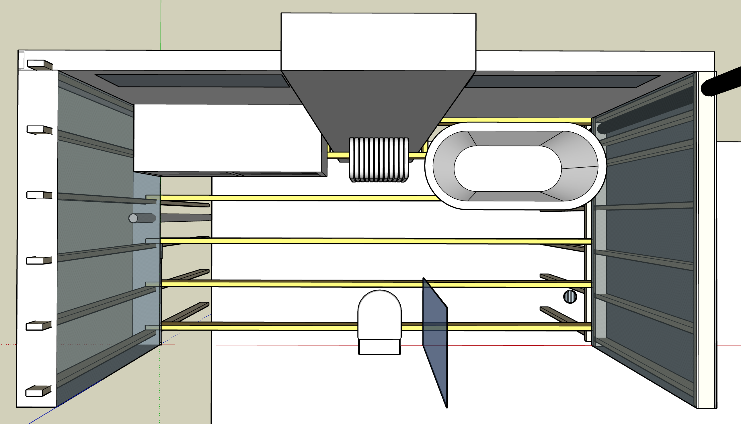

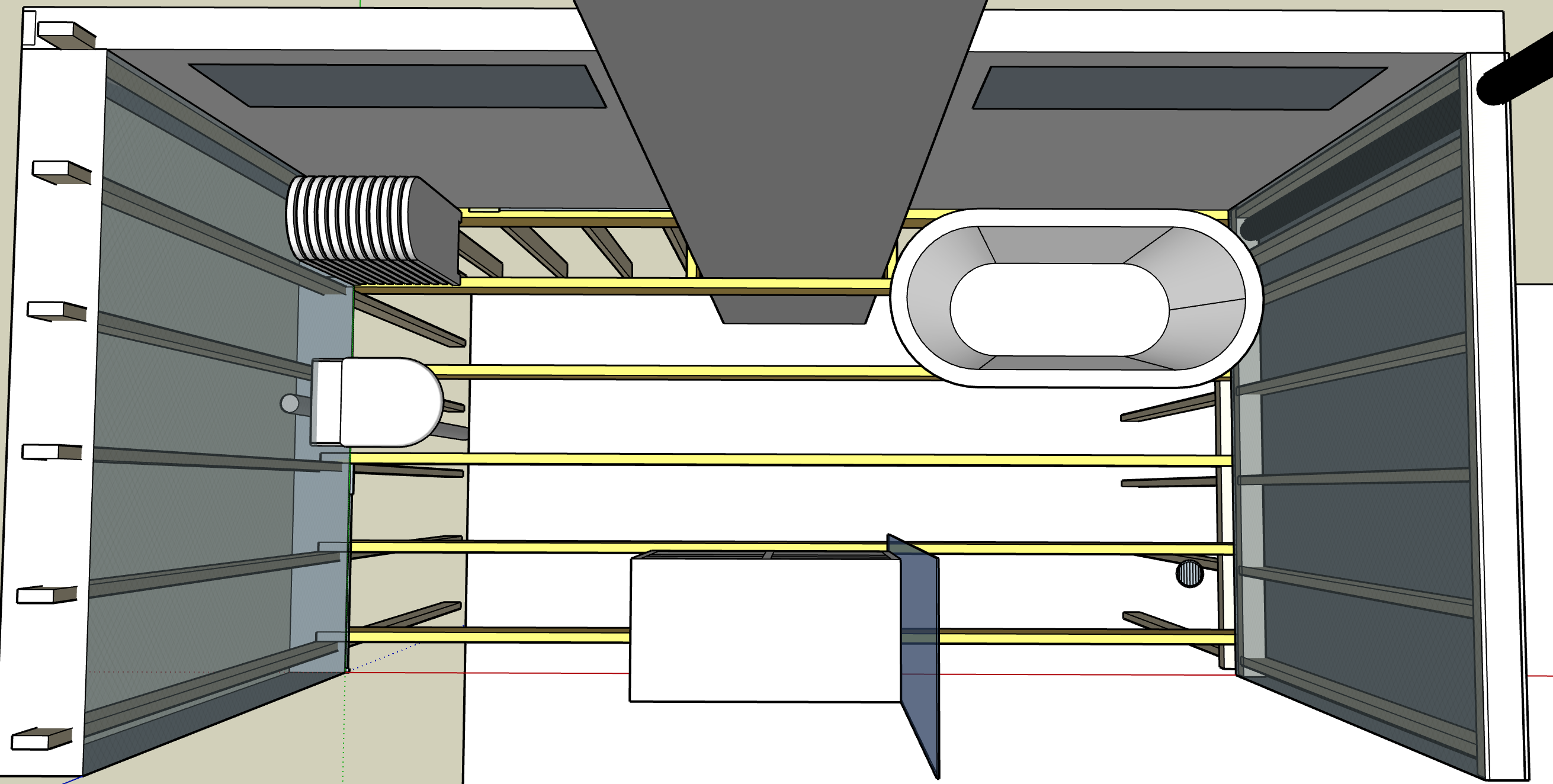

How about a top down view with joists of your preferred toilet location? Personally, if I thought that was a better arrangement, I wouldn't hesitate to drill two joists for the 3" toilet line, using those reinforcement brackets I linked to earlier.

How about a top down view with joists of your preferred toilet location? Personally, if I thought that was a better arrangement, I wouldn't hesitate to drill two joists for the 3" toilet line, using those reinforcement brackets I linked to earlier. Cheers, Wayne
In this scenario, with the lav already down near the drain, that would be back to one of your earlier suggestions where the drain comes out of the lav where the bath connects, then the shower, then the toilet and then to the stack, yeah?
Here's the top down view:

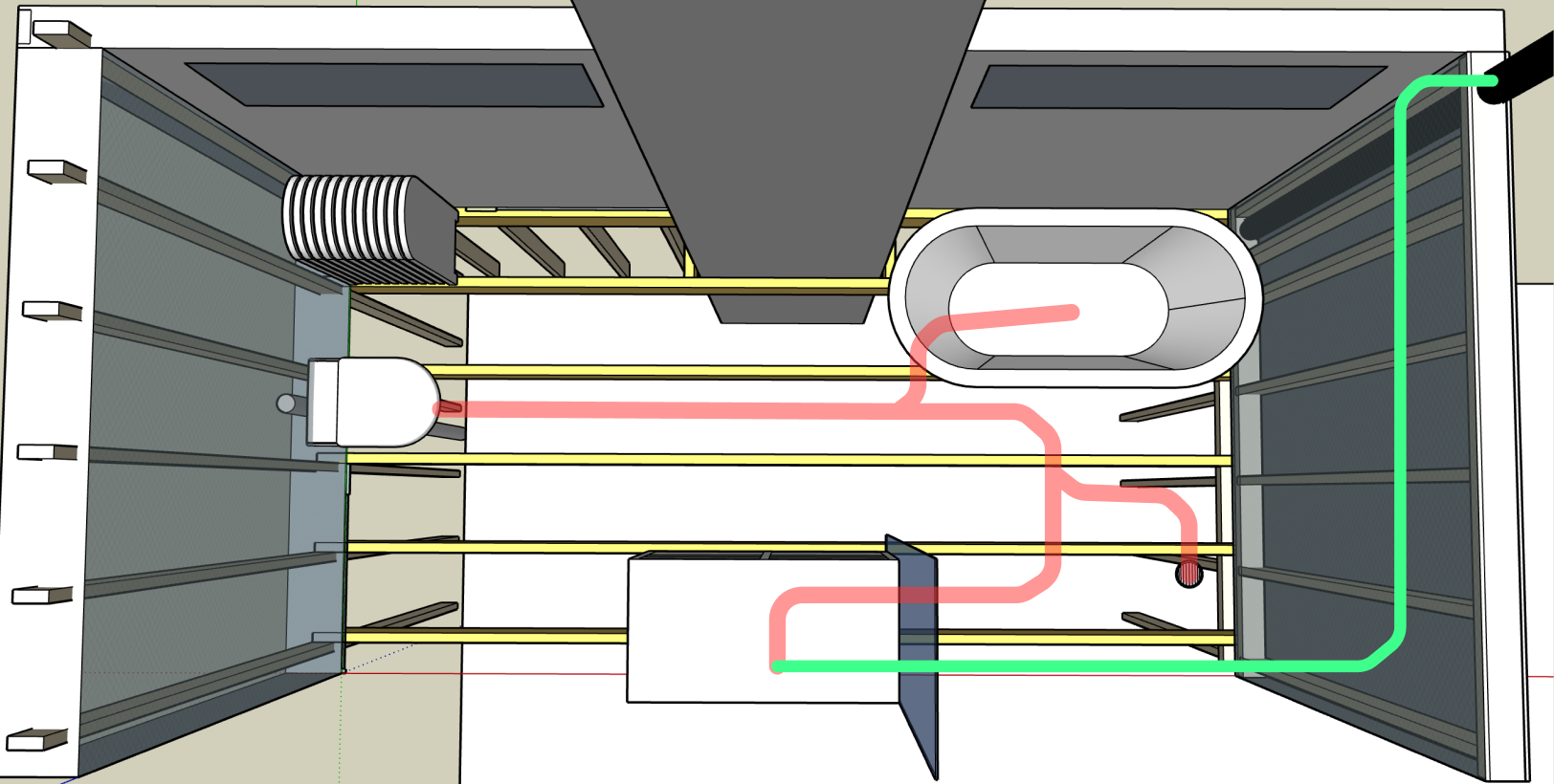

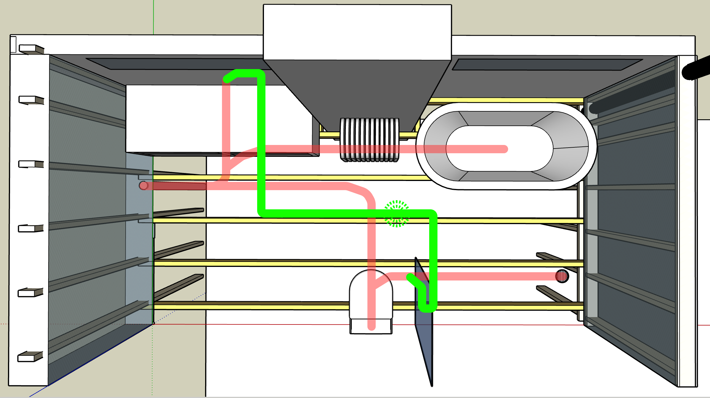

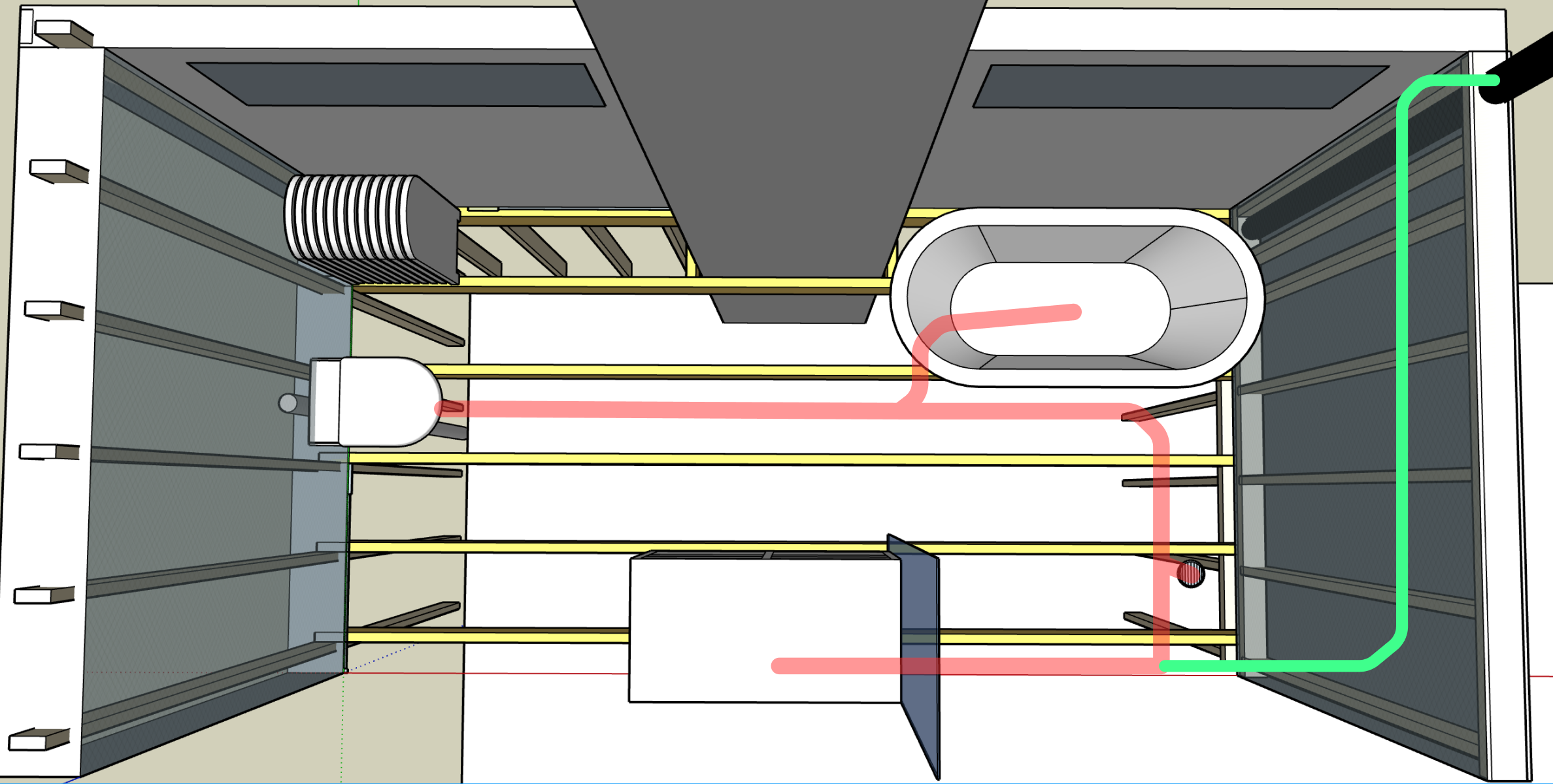

A couple options for your consideration based on the last overhead view. Green is vent, red is drain, and orange is alternate drain path.
With the shower drain so far from the lavatory, I don't see how you could reasonably wet vent the shower using the lav. I assume you're doing a monoslope shower with a trench drain at the end, that's why the drain is so close to the wall? You can take advantage of the proximity to the wall to dry vent the shower fairly easily. The shower then wet vents the tub and the toilet. I drew the lav san-tee very closet to the chimney, but in this plan there's no need for that, it can be anywhere you want left-right.

And if you are interested in moving the shower drain to the entrance side of the shower, then I think you'd be close enough to reach the lav for a wet vent. The orange is an alternate "cut the corner" path if necessary to stay under 8' trap arm length. For the two wyes in one joist bay, you'd want to use a street wye for the upstream one (and possible the downstream one, depending on where a long turn 90 (rather combo) puts you and whether you can poke the hub end of it through the joist without an excessively large hole).
Yes, shower is curbless and pitching away from the main floor area and tub. This layout makes sense, but this means there are two vents that need to be tied into the cast iron, right?
Sure, but they can combine with each other before tying into the cast iron. So the difficulty at the cast iron stack should be the same either way.
How are you going to achieve the curbless shower pitch without chewing up your joists? While somewhat unusual, a pitch towards the entrance would mean that you are building up rather than sloping down. Could be tricky to get the details right, but one advantage would be moving the drain closer to the lav, which I think would make wet venting everything via the lav feasible.
Plywood is being lowered to be level with joists while the surround subfloor will be bumped up a bit.
I ended up having my plumber come over for a consult. After we checked out the condition of the cast-iron, it was pretty clear it wasn't something I should try tapping into, so I'm proceeding with a new PVC vent out the roof and a layout similar to your recommendation:
