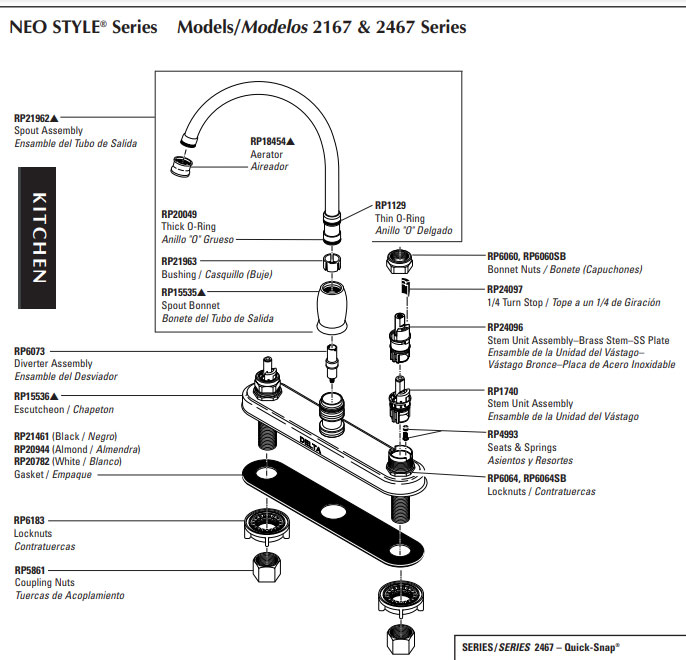

Hi,
I have a Delta faucet that is leaking from the faucets and the spout base only when either faucet is turned on. Delta will warrantee it if I can remember when it was installed, which I can't. Can anyone ID this faucet so that I can buy the correct cartridges and seals for the spout?

I would take the valves apart to take photos of them to send to Delta. They should be able to identify them that way. The cylindrical collar at the base of the spout should spin Counter Clockwise (looking down) to release the spout.

Delta NEO STYLE 2167/2467

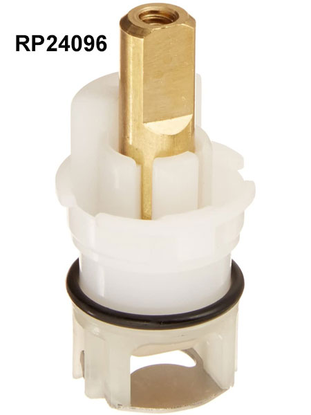

For a cartridge replacement use the RP24096. It has a brass stem to allow for side handle set screw.

Marlinman nailed it. Delta told me it was a peerless but the parts diagram didn't match what I had. I replaced the parts and no more leaks!.
