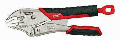

That looks very inaccessible. Does that tank tee have a union on it on its way into the tank? If so, I am thinking you might put a union on the output copper pipe, and pull the tank tee away. Then you can get wrenches in place or big locking pliers. Maybe use a bench vise. I like the Milwaukee 10-inch curved jaw locking pliers.

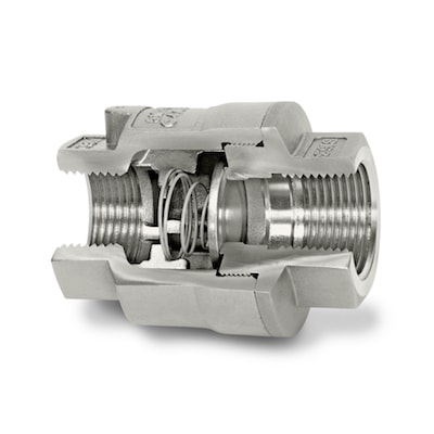

I am able to put a 24" pipe wrench on the check valve. The tee feels like it will collapse if I put enough force on the pipe wrench.
With some check valves, you can remove the poppet and spring. The check valve just becomes a connector. I have never done that. Here is a view of a check valve:
Maybe see if yours might come apart.
I don't know if that would apply to your check valve. I am curious what the protrusions on your check valve are.

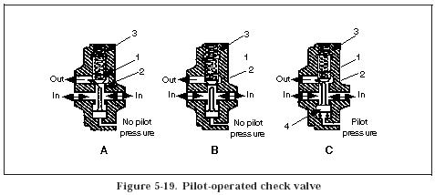

I was curious too. It has (2) taps on the left discharge side. The one on the top is plugged. The one on the front side has a 1/4" sample/drain valve.
There are two protrusions on the inlet side that have not been drilled and tapped. There is one protrusion on the discharge that has not been tapped.
Found this image. Click on image for link.
