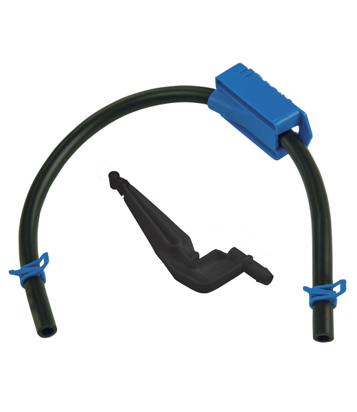

I read the "Small Hose in Toilet Tank" thread and now understand what is happening. The fill tube fills the bowl, but there is too much water going through the fill tube into the overflow tube. That's because the blue flow adjuster was not installed on the tube. It will fill the bowl quickly, but continue to dump water into the bowl, which maintains its waterline automatically.
The Kohler valves (presumably made by Fluidmaster) have a set of colored fill tube connectors which are used to adjust the amount of water that goes into the bowl. So I'll either get a Kohler fill valve or look for the blue flow adjuster part.

change the small hose to one with an ajustment wheel and slow down the fill through small tube so that bowl fills slower (follow adjustment procedure)
