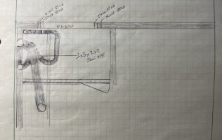

latest drawing with what apears to be a 1 1/2 dry vent below the floor cant be dry or 1 1/2 if serving the w/c needs 2 inch

Ok, how about this. A 3x3x2x2 Sani-wye. 2nd 2" comes off and goes up wall and then runs increasing horizontal to tie in with 3" vent stack?
I am attaching pictures from previous version only so you can see the tight run from the shower p-trap and what moving the window would look like. Also so you can see the limited space I have to cut out the 3x3x3 sani-tee behind the double joists.
No, a dry vent takeoff may not be on the horizontal, it needs to be on the vertical and come off the upper half of the cross-section. Also, the 3x3x2x2 fitting you show is called a double wye and isn't to be used on the horizontal like that. [Well, it's possible but tricky with some extra considerations I don't want to get into now.]
Where is the lav drain going to be? Can you reroute it, upsize it and its vent to 2", and use it to wet vent the shower and the WC? In WA state, the WC is not required to be last on a wet vent (an amendment to the UPC), so you could make your original WC/shower geometry work from post #14 simply by joining the 2" dry vented 2" lav drain to the WC before the shower joins it.
Lastly, you could pull a 2" dry vent off the shower directly under the wall and rise up to the left of the window if you can get around the corner higher up in the wall or in the ceiling framing or attic to reconnect to 3" stack.

So I think you've got 3 viable solutions, you can figure out which is the least trouble for you:
1) replace the 3" san-tee on the stack with a 3x3x3x2 san-tee with sanitary side entry, bring the shower drain to that side entry (requires drilling the double joist for the 2" shower drain)
2) pull a 2" dry vent off the shower drain so it can wet vent the WC; the 2" dry vent rises to the left of the window and then needs to reconnect to the stack (somewhat annoying as that wall is an exterior wall).
3) redo the lav drain and vent as in the previous post (requires drilling the double joist for the 2" lav drain)

Well I decided to do a combination of #1 & #3. Completely redid the lav and vent with 2" (ignore the vertical length, I will cut that and add a cleanout when I get the 3" drain/vent in place. Because the existing 3x3x3 was sitting too high to get correct slope and also to get to that 1-1/2" previous lav drain, I cut the 3x3x3 out and re-ran the whole thing.
Before I glue this up. Just want to make sure I did it right, If you guys wouldn't mind?

The arrangement is compliant with the UPC.
Function-wise, it would be nice to avoid the two LT90s on the shower trap arm and avoid drilling that joist twice. The 3x3x2 wye for the shower could be a street fitting directly into the 3" san-tee on the stack, and then maybe you could avoid one LT90 by turning the trap outlet? Or at least change one LT90 to a 45 by turning the trap outlet?
I didn't try a street union (?) but I can. Just seemed like with the double joists right up against the 3x3x3 stack and trying to get my 1/4 turn with gluing, I didn't have enough bay space to fit the 3x3x2 with a 45, street 45, 90 or street 90. But I will give it a shot.

I was suggesting a street 3x3x2 wye, a fitting whose outlet is a spigot instead of a hub, so it can go directly into the 3" santee. That would move the 2" inlet closer to the edge of the joist bay, maximizing the space you have for a (street) LT90 within the same joist bay. But that might move the wye too much towards the exterior wall so it wouldn't fit within the existing hole in the joist.
