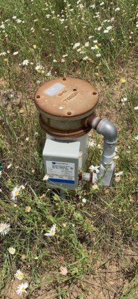

Sorry for the delayed response. Dealing with this crazy ice storm here at home. Here‘s a pic of the whole setup

Interesting. So went back and tried to relate this all to you your original PDF.
Is that a pitless unit or is that a cap over a pitless unit? It must be. If you lift that cover, there will be wires. Was your original PDF based in part on what you saw under that cover (well cap)?
Would the new pressure tank and pressure switch be in the barn and protected against freezing? Would the pressure tank and pressure switch be underground near the well, to prevent freezing?
