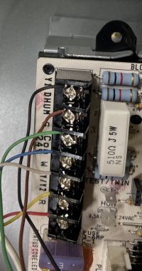

Bryant 127ana060-a
Had issues a few years back with it. A switch of some kind broke in there so they bypassed it. I don’t think they would have hooked it up wrong, but…I wasn’t sure why the stage 1 wasn’t running the compressor at all. I wasn’t sure what the behavior should be. And can having them switched hurt anything if it is wrong?
Here are pics of the wiring at the stat, the furnace, in the condenser, and a schematic.
If I am right, Y1 is black, y2 is yellow. According to the schematic, y2 should go to blue and y1 should go to yellow/pink. But in mine you can see y1 (black wire) goes to blue and y2 (yellow wire) goes to a yellow wire.
The blue wire goes down to the compressor and comes back a red wire. The yellow wire connected right to the contact switch.
It’s not pictured here but today I switched them. So yellow from the inside now goes to blue and the black from inside now goes to yellow. Wondering if that was ok to do.

Looks right. Having y1 & y2 swapped compressor would only run when 2 nd stage called would run at 100% capacity and if stat was set at 75° it would cycle 76° to 76.5. Would depend on the offset for 2 nd stage. This problem shouldn't shorten the life of the compressor.

Thanks for looking. Ok so if that pic looks right then I need to switch it back to look like the pic? I guess I’m reading the schematic wrong.
