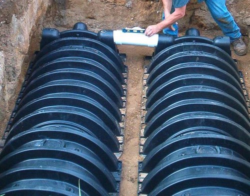

In a system that old, your septic tank might be discharging into either a dry well or a leach field "finger" or "trench" system. If you know the size of your septic tank, you could guess as to whether a week or so of your water usage would fill it, and I would suspect that is likely the case. As others have said, you probably need a new drain field in the ground beyond your tank, and I would guess your tank is fine if it is large enough for your local, present-day codes.
If you do a little digging at the far end of your septic tank, you will find the discharge pipe going out into something, and that "something" could be either a dry well or a smaller distribution box feeding the fingers of a new-style field system. If you want to check things out on your own, just do a little digging at the end of your septic tank to find that pipe and follow it a few feet to wherever it goes, and then take a look inside that next component. If you can handle doing that to learn a little more about your system, it might be far easier for you to call around for someone to get the permit and do the repairs. One problem you might run into, however, is that your local codes might now require a larger septic tank than was acceptable back in '64.
If you end up needing a new field system as seems likely here, see if maybe you can find a manufacturer of septic tanks nearby and ask those folks for a couple of recommendations as to who to call for possibly doing your work. And if you have a couple of shovel buddies who might want to help make this a DIY project, I can tell you how to get it done for dimes on the dollar.
