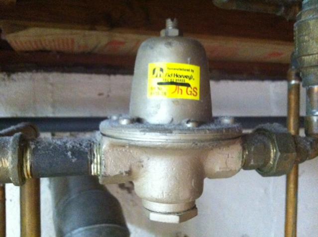

My fill valve is not filling. I adjusted the screw on top and I do not see pressure building in the boiler tank. Last fall I had a similar issue. Then I adjusted the screw a 1/2 turn and it adjusted pressure correctly. This year the screw seems to do nothing. I lowered it and raised it wil no affect. Boiled still only has 2psi. Does this unit fail in this way? There also seems to be a cleanout on the bottom. Is this another option to free the blockage? Or just replace?

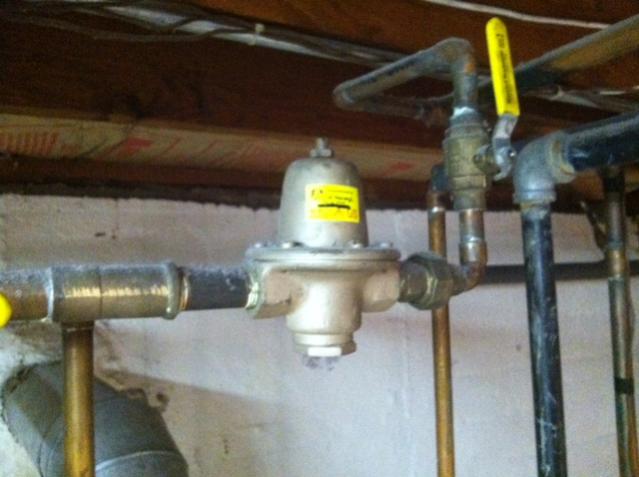

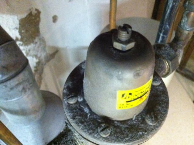

These are pics of my valve. It looks a little simpler than your pic. I have 2 pressure gauges on the reduced size of the valve. both read 2psi so i am confident the valve is not releasing water to the system.

It has outlived it's usefulness. Replace it. There is a screen inside it and it probably is plugged but usually the spring and diaphragm are bad too.

I agree, I will replace it. It should be an easy swap out with the union on the right side. Does anyone know this model? I would like to get the same size unit with the same clearences so I do not need to change any piping.

Maybe you don't need the same brand if you can find one in a similar size and shape like this one at Grainger might be:
http://www.grainger.com/Grainger/BELL-GOSSETT-Water-Pressure-Reducing-Valve-6LFA3?Pid=search
Of course, you'd have to measure, but they only have 163 different ones so you should be able to find a match at any major supply house. At mine, I usually measure and bring a picture with me and a good plumbing supply nearby can usually tell me what I need from the picture.

I would replace it with a Watts S1156F/9D combination because you need a backflow preventer too.

Strange thing happened last night. I tightened the adjustment screw all the way. Water did not flow. = bad unit. I go to parts store and get a new unit. I figure I will install it this weekend. (I have time before I have to use my heat) I am sitting on the couch and I hear a loud hum. I went down to check it and the spring in the bad unit released. wated started to flow. Obviously the unit is all bad inside. boiler got 20psi. I dialed back the scrw and released some pressure down to 12psi. Plan to change out unit still.

If you could find one which I doubt, the overhaul kit would cost more than a new valve. There is no need to install another pressure gauge, there is already one on the boiler and there really is no adjusting. They come set for 12lbs and unless you have a 6 story house there is never a need to exceed that.
