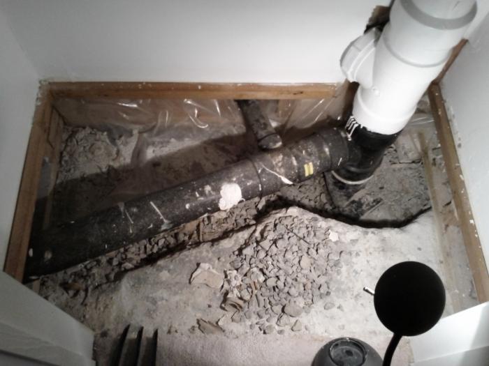

    Hi:
    Our house is 25 years old and we bought it 20 years ago.
    The house came with a completely finished (drywall ceilings and walls,
    carpeted floors) basement, except for the utility room.
    The basement was put in by a prior owner and it was a contra deal and
    basis what I see , done without permits. The problem is with the toilet
    in the basement as it is sits on a 6 or 8 inch riser.
    With the kids gone we are thinking of selling and everyone tells us we
    need to get rid of the riser under the toilet.
    The pipe from the toilet runs into the adjacent closet and we lifted the
    false floor to see what we were up against and what we found is in the
    attached picture (hope it comes through).
    The vertical pipe comes from the bathroom on the second floor.
    I have lots of questions...
    1) will the plumbing code even allow a toilet and lav to be connected to
    the pipe from the second floor?
    2) Is there enough room in the closet to put the necessary fittings in
    to lower the toilet?
    3) any idea what might have caused them not to put the pipe under the
    concrete?
    I won't be doing this work as it is out of my league. I will be bring
    in a plumber to do it and get the requisite permits. All I am really
    trying to do at this point is determine if it is possible to fix it
    without having to destroy the basement.
    many thanks...
    Rob

    I'll answer number 3 right away... The guy doing the work was a hack.
    What else does that stack serve, the entire floor above or a single bathroom?
    Jan 2008
    2,674
    I would speculate that the installer did not like to break concrete and dig any more that necessary.
    The first thing that needs to be determined is whether you can make the connection properly and still have proper pitch to the building drain.
    In the bigger picture, how much will it cost you to make the bathroom of enough value to pay for itself in the sale? Financially, it might be easier to remove it and repair the floor.

    They make back flush toilets were the waste line can be roughed in 4" above the finish floor. The toilet sits on the floor but flushes out the back. What I can't see is if the toilet and sink are vented properly.

    The stack serves just the 2nd floor main bathroom. All of the other bathrooms have separate stacks.
    Venting, I have no idea as the entire basement, including the bathroom is dry walled..
    The distance from the center of the toilet outlet pipe to the center of the stack is 51".
    The TOP of the drain pipe in the ground is 5" below the top of the concrete floor or about 2.5 " below the concrete. On top of the concrete there is a 2 x 4 on its side with a 3/4" plywood sub-flooring on it.
    As for the 'hack" comment, The entire finished area of the basement has 3, count em, 3 electrical outlets. They are so cheap and easy to put in when the walls are open and so expensive and difficult to put in when they are closed.
    The sad part is that this bathroom is heavily used (my office used to be in the basement) and it has given us zero problems in 20 years.
    thanks again
    Rob
    How it is done determines its legality, not IF it can be done.
    No. the tee for the bathroom is sitting on top of the lateral main so it is as low as possible. The connection would have to be made somewhere in the horizontal piping. And, again, it would have to be done properly.
    concrete?
    They did not have enough room given the connection they made. They did it "quick and dirty", not "properly".

    I installed a sanaplus toilet that worked very well. The night after I installed it the owner had a Christmas party in 2010 with 3,000 guests. It worked flawlessly he said and is still working as of a month ago. Not sure if it could help you but the outlet of the toilet is well above the floor and it has a macerating pump inside a container that will pump the waste through a 3/4" pvc pipe. There are heavy restrictions on routing the discharge line.........it must be done as directed.
