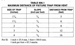

Well the fixture outlet coming off the kitchen sink is VERY GOOFY but not against code. However the running trap you have drawn in there is against code.

So you won't be able to remove the DW without breaking the counter? Not the best plan but your call. Now that you have shown a vent it won't siphon the sink trap but you still have a running trap in that line. You would need to install a trap then Y it into the line.

bitsdoo, you left things out : I'll bet there is a sink near the shower. The trap arm for the shower may be OK without a vent, if it is short enough and wet vented from the basement bathroom lav.
i find it hard to believe the double trap is there.

No "competent" plumber would have installed the drain line the way you show it. You do not have a trap for the dishwasher drain, and may be showing it connected directly to the drain riser. This appears to be a case of someone thinking, "anyone can be a plumber. All it takes is some pipe and a lot of fittings as long as it angles downward".
