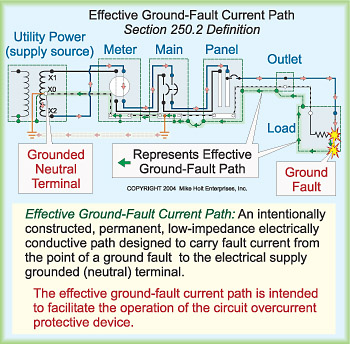

    the pump doesn't require grounding because it is usually very well grounded in the water in the well. But it doesn't hurt unless the ground wire is broken and you are used to make it.
    This comment scares the hell out of me, A pump without a low impedance path back to the service will NEVER trip the breaker, the earth is NOT a low impedance path. Your gonna kill someone.
    Actually IIRC, grounding the casing is not what the codes call for, they call for use of metal well casing as the building's electrical system's ground electrode.
    Actually the NEC does require the casing, if metal, to be bonded with the EGC that supplies the pump motor, NEC 250.112(M) And no, you dont have to use the well casing as a GEC.

    Quote Originally Posted by Chris75 View Post

    Wells and pumps are not my primary business, water treatment is, and I must have been in maybe 3-4000 houses and businesses right next to pressure tanks and switches without a grounded submersible pump or well unless it was a 120 v submersible pump; they are very rare. That's OMG! only two 120v wires running from the pressure switch to the sub pump up to 200' from the house and the pump 500-600' deep in the well.
    So you have no electrical background what so ever? Your not the guy that steals the grounding wire off a 240v well pump circuit for a 120v receptacle for the water softner are you?

    EGC is Equipment Grounding Conductor
    GEC is Grounding Electrode Conductor
    The Nec is mandatory if your state has accepted it and adopted it. with the exception of state amendments.
    Here is a picture to help you grasp the idea of a grounding conductor.
