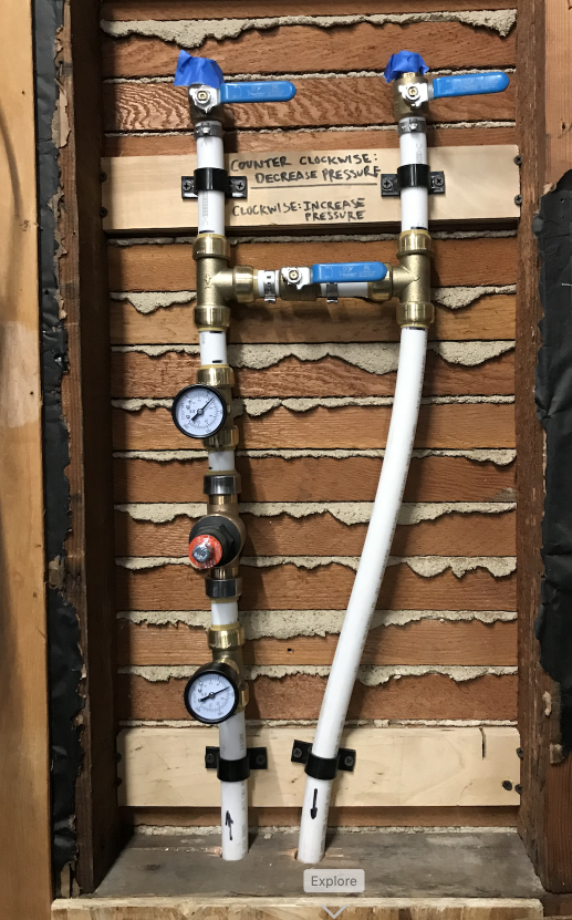

Spent the weekend running new plumbing lines to a whole house filter I installed in the garage. Used 3/4 PEX to connect to the main line with a combination of SharkBite, clamp, and sweat fittings . Everything went great, no leaks, and the also installed PRV has helped immensely with my water hammer problem (a 15-psi drop worked wonders).
Water service on the left, supply to the house on the right.
However...

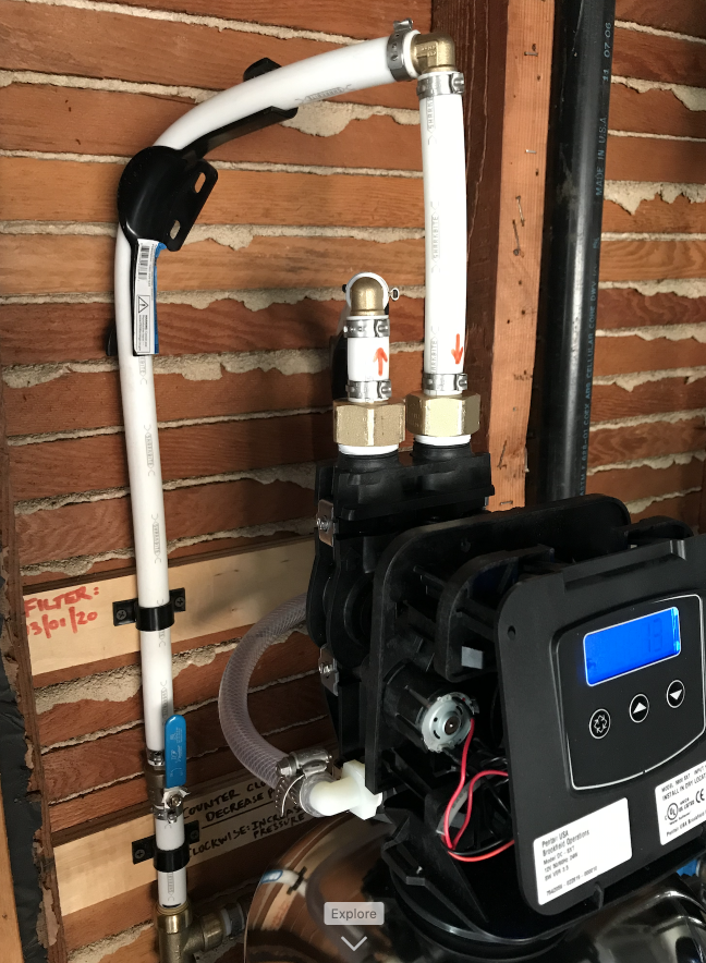

My water filter (HousePure HP-02-CHL), which uses a Fleck 5800 SXT control valve, has the outlet on the left and the inlet on the right. Not paying close enough attention, I mistakenly hooked up the water service to the outlet, not the inlet. I then proceeded to fill the tank and run the backwash and rapid rinse cycles.
I inspected the water from the drain during RR and once it was clear, I put the valve into service and opened the bypass to the house. Testing a sink faucet, I started getting quite a bit of carbon in the water flow that eventually clogged the faucet. Long story short, I drained the house lines, did the BW/RR cycles a few more times, pulled the aerator, and the water eventually ran clear throughout the house (even with backwards connections).
The following day, I noticed the flow indicator on the 5800 wasn't working. Research brought me here and soon enough, a linked 5800 rebuild video made me realize I had connected the lines backwards. I corrected the connections, reran the BW/RR cycles, tested the water, and once again reopened the filter to the house. Clear water, but I'm wondering...

A PRV Would normally be on the input side, unless you are concerned that the PRV might limit the backwashing rate too much. I think the max pressure allowed for the Fleck is 125.

That PRV should be on the input side.
The PRV is on the city water side. My water pressure is around 78psi and I wanted to bring it down to 60-65. Also, the spec sheet for the filter said 75psi max:
It probably would've been OK to leave as-is -- 5800 documentation and even the filter install documentation both state 125psi max -- but the lower pressure seems to work better with the water hammer arrestors I have on the washing machine, ice maker, and toilet, which I believe need around 60psi to be effective.
In hindsight, I should've plumbed the pipe from city water on the right side to match the connection point on the Fleck. Staring at the city water line on the left side the whole day impressed on me that it should connect to the valve on the left side as well. Oh well, rookie mistake.
I ended up having to overlap the in/out lines to make the correct connection and I'm not all that happy with the way it looks. Fortunately, it's not copper so I can easily rework it. I used the vendor supplied elbow to orient the control valve bypass vertically as it was easier to do the overlaps for the proper connections, but now the cover doesn't fit as the bypass knobs block it. Still some work left to do!

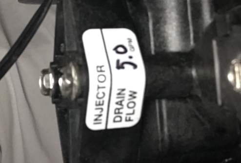

Is there a label on the control valve which indicates the BW or DLFC (drain line flow control) flow rate?
There's this:
All other stickers show model number and serial number.
Still thinking about this. When you say input, did you mean I should install it on the outlet line from the filter? Just to be clear, the PRV is installed on the city water side, before the filter (it looks confusing in the first picture because I installed the city line on the outlet side of the valve).
It's odd that the spec sheet calls for a max pressure of 75, even though the valve and installation manual state max as being 125 psi.
How much pressure, if any, do you think I'm losing to the filter? Thanks again for the replies, I really appreciate the help!
As it should be.
You have a pressure gauge on the output of the PRV. You could backwash and find out. I expect the filter to be OK with 30 psi or more. With only a 5 gpm backwash, I don't think you will have any problem maintaining pressure. Backwash could have been 10 gpm as far as I knew at the time.
Does your PRV have a screen? Some do. Does your PRV have a replaceable cartridge?
Have you tried rotating the bypass so the knobs face the backside wall? Alternatively, you may be able to rotate the Fleck bypass downward behind the tank so the lines connect from below.
As a further idea, remove the Fleck bypass completely as you have a 3 valve bypass incorporated in your plumbing, thereby making the additional bypass control redundant.
Flexible connection lines such as braided Stainless Steel would allow some flexibility to permit the filter to be moved while remaining connected.
https://terrylove.com/forums/index.php?threads/setting-up-fleck-5600sxt.67554/#post-501959
You're right. This is the route I will take. I'll pick up some braided lines tomorrow. Thanks!
38,903
4,439
Avoid braided. Those are rubber tubes with a covering, and are more failure prone plus they are usually very reduced ID. Corrugated connectors are good. You can get those with full ID maintained. Consider Mega-flow SUPER Water-flex stainless steel.
