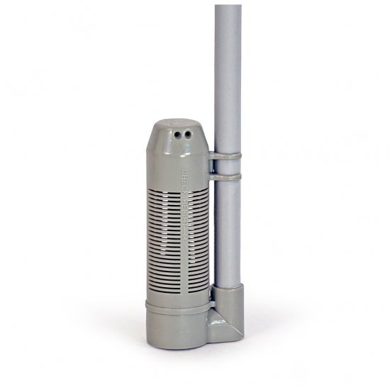

You need the water to fill higher than the grid. Or else the water does not turn into saturated brine. You may need to raise your air check valve to compensate. The air check valve determines how low the brine gets sucked down to. Refill adds a fixed volume.

I would raise the air check valve to make sure the water in the brine tank fills to higher than the salt grid top. That way the liquid would for sure meet salt. Also raise the safety float valve if there is any question. That float valve is really to make sure the liquid does not rise so high as to spill out.
Note that the liquid in the brine tank is usually lower than the liquid in the brine tube.
You will want to add some water down the brine tube to compensate for the raise.
